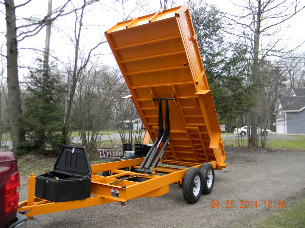

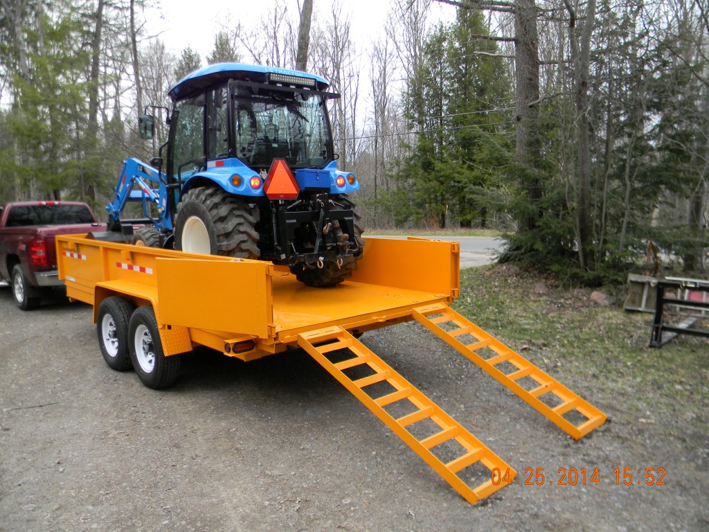

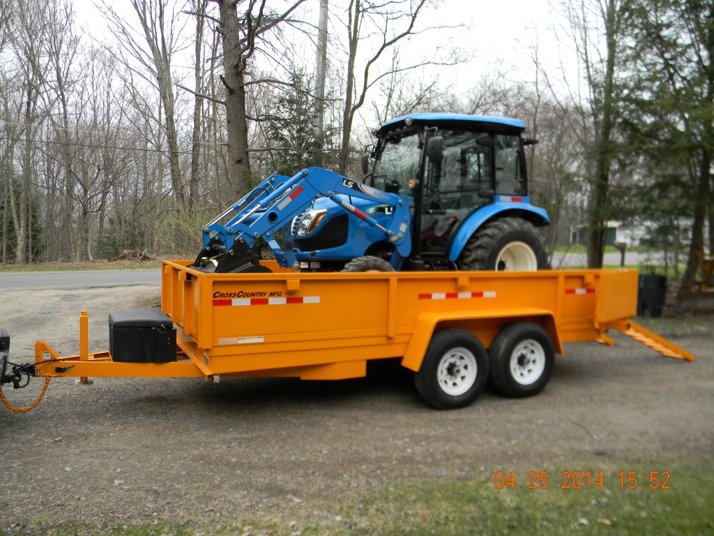

I have a 16' Cross Country dump tag trailer. Weighs about 3800# empty. 80" wide. 24" deck height. Can haul 10K. Has 4 D-ring tie downs in bed. However, no room to add a 50 gallon fuel tank.

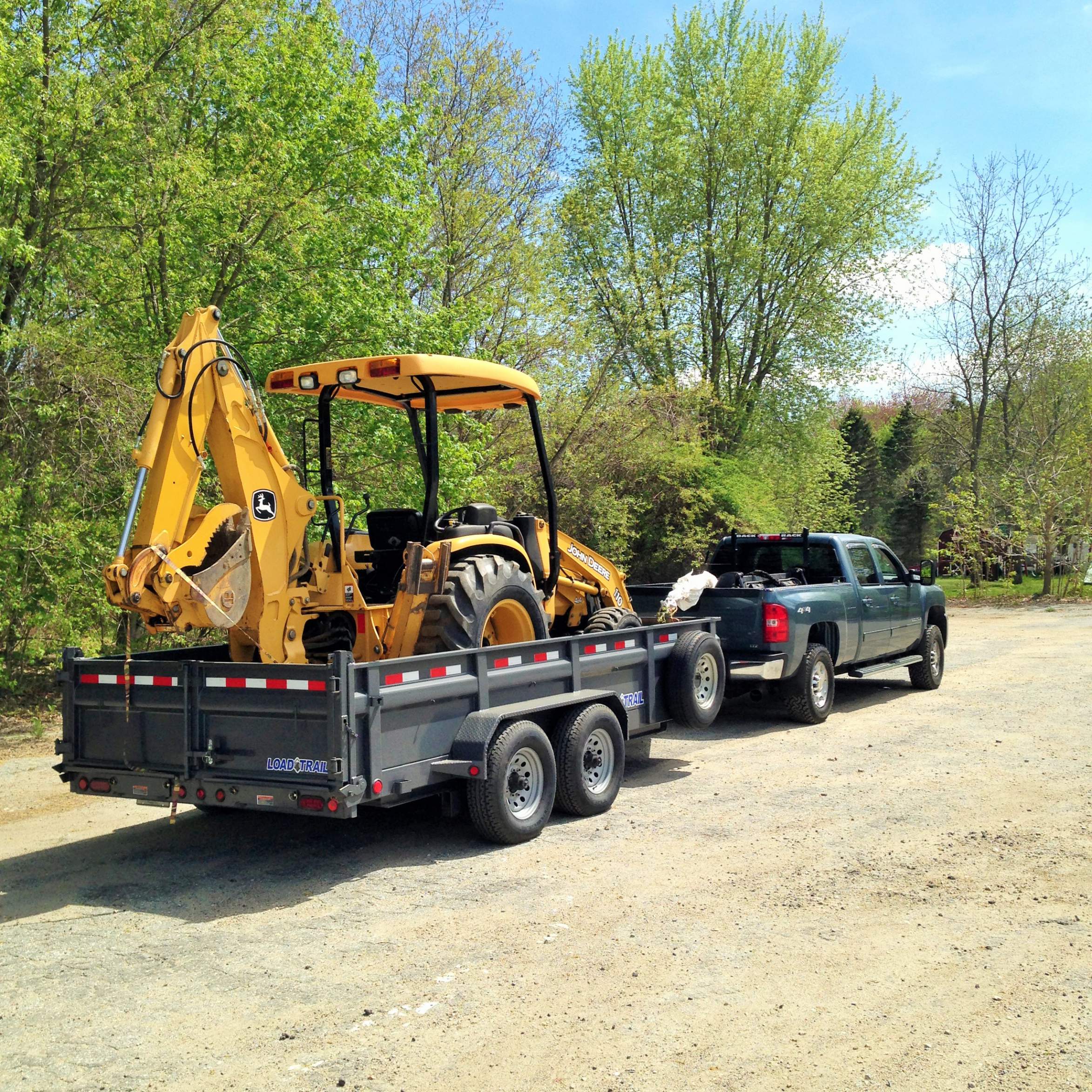

I haul my 8k TLB in a 16' low profile dump. It works of as a jack of all trades trailer but it I hauled with any frequency I wouldn't recommend it.
I ordered mine with fork pockets as your space limited with the dumps. Load placement is not idea at all and frequent adjustments are often needed.
Securing the load is also a hassle when hauling equipment in the dump.
After having this trailer for a few years I'm getting the itch to buy a dedicated flatbed since when ever I need to trailer the machine I usually end up needing several attachments.
