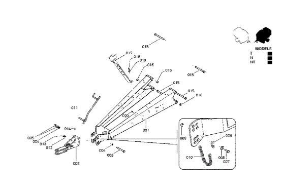

Not exactly sure on the specs. But remove the tongue and it can prolly sit sideways on a flatbed…
