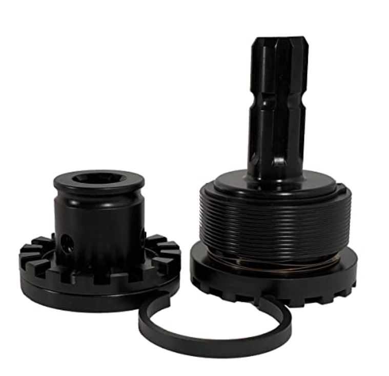

I'm using a quick connect adapter on my mowers. Not cheap but for sure easier.
