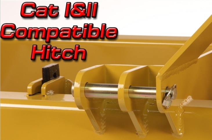

I bought a quick attach from Northern Equipment for my John Deere 2305, new toy. Most of my attachments seem to attach ok, but my box scraper pins are to short, can I simply buy longer pins?

My box blade was set up with too narrow a pin spacing also and after thinking about the amount of force put on the pins with the digging and gravel spreading I planned on doing I didn't think longer pins would last too long.
Several HD blades come with pin setups like this, so I added a few plates and used a long bolt with the correct diameter bushings to copy something similar to this picture, works great, and I don't think I'll have any trouble with bending any mounts.
( thanks to EA for the pic)
