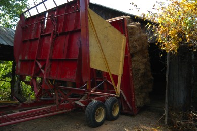

We trying out a New Holland model 1033 automatic "Hayliner" stackwagon, capacity 104 square bales.
Little problem--our barn's door is not compatible. Do those things get heavy when the unloading is by hand!
More to come,
Jim

If you're going to unload the wagon it's usually easier to dump the stack by the door you want to move they hay into. Usually trying to unload them off the stacker is alot more work.

1- After getting the 1033 inspected by a NH expert mechanic and finding numerous welds (mostly bad) underneath, I have agreed with the owner to return it with no obligation. Mech said it needs major redo. Watch out, Banjo and others--get under/over and all around prospective machines. Be wary of parts that don't look true especially where you see welds. A bunch of out of line metal is making the first table stick fairly often on this machine, among other problems.

3- CowboyDoc is right by my experience, so I am trying to find ways to cheat using sliding carriers made from plywood, etc, to lay the loads onto. May need to move the door header up some, also. Will let you know if I succeed.
