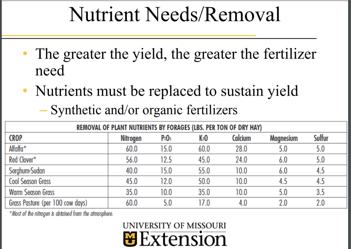

And the removal rates (and needed replenishment rates to maintain yields) of NPK and other nutrients depend on the forage -- http://extension.missouri.edu/mcdonald/documents/compressed Hay Fertility1.pdf.

My recommended rate is 50# of N per ton of hay removed. It is paramount to getting quality and quantity off of a field . I see so many people mining the fields and always looking for more hay ground when they could do more with less if they simply applied according to soil test and actually tried to build up the soil.

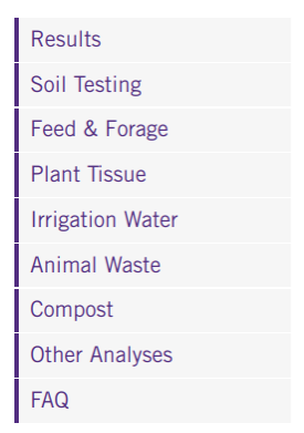

Many (most?) land-grant universities offer soil- and other-testing services for nominal fees, and in some cases the soil tests are free to instate residents. Here's a listing of the testing services offered by Clemson -- I suspect other land-grants offer similar services.
