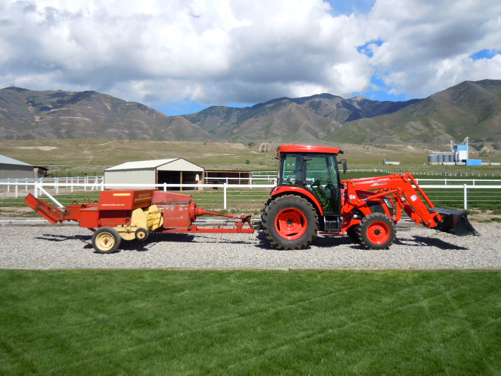

I started doing my own hay this year. I had no equipment. This is where I'm at now;
RX6620PS/cab with land pride scrapper and disc harrow as a package deal. (all new) $40,500
New Holland 316 bailer (used) $4000. Replaced the twine knives before season, no problems worked great.
New Holland 9' 488 haybine. (used) $2000. Replaced all the guards and lots of blades for about $250ish. Worked great no issues.

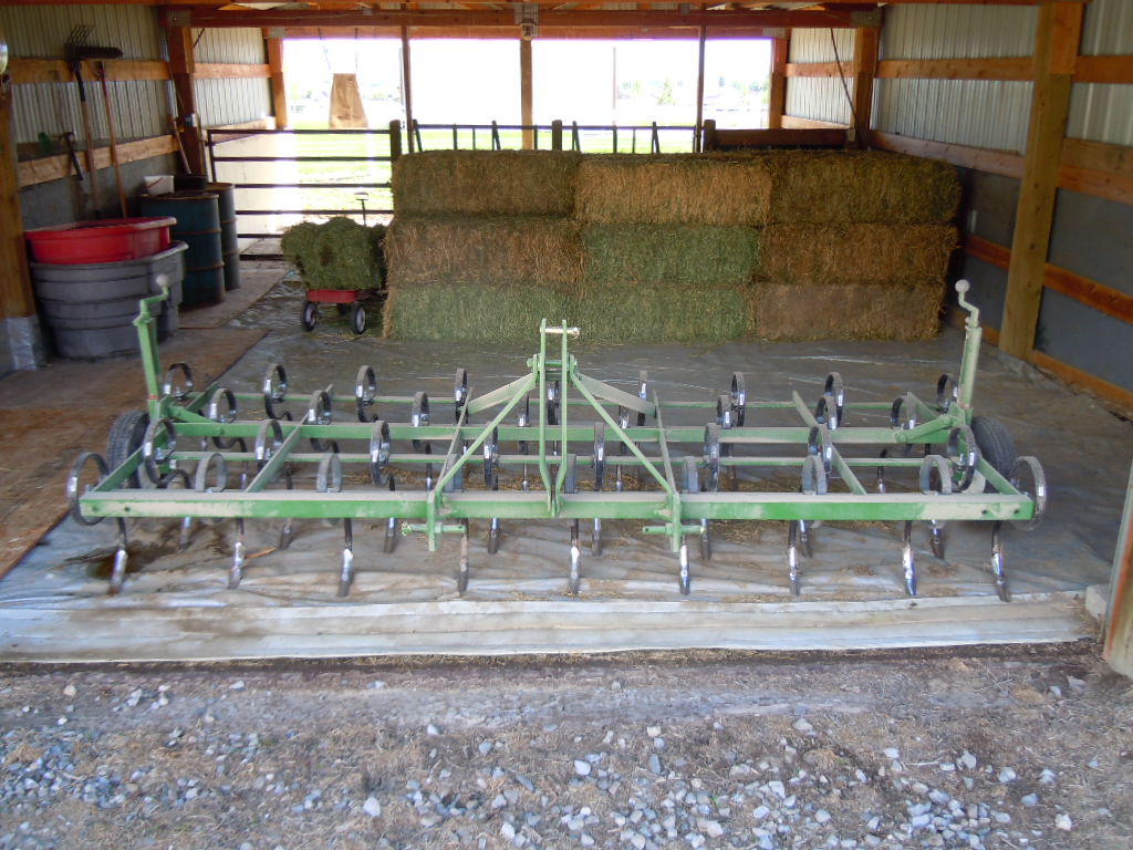

11' spring tooth harrow. Not sure of brand. $1500 was restored before I bought it.
I could have bought a used tractor but well uh I didn't want someone else's. I still need a v-rake ($1200) which I will have before next season and I need a drill seeder. (cost ??? still looking)
As you can see it's not cheap, but I have enjoyed doing it. In retirement it will give me reason to get up.
As BWfarms said; you need a bigger tractor.
O, and throw in about 15 grand ish for a new 45'X72' pole barn I will build myself this fall to keep all the equipment in.

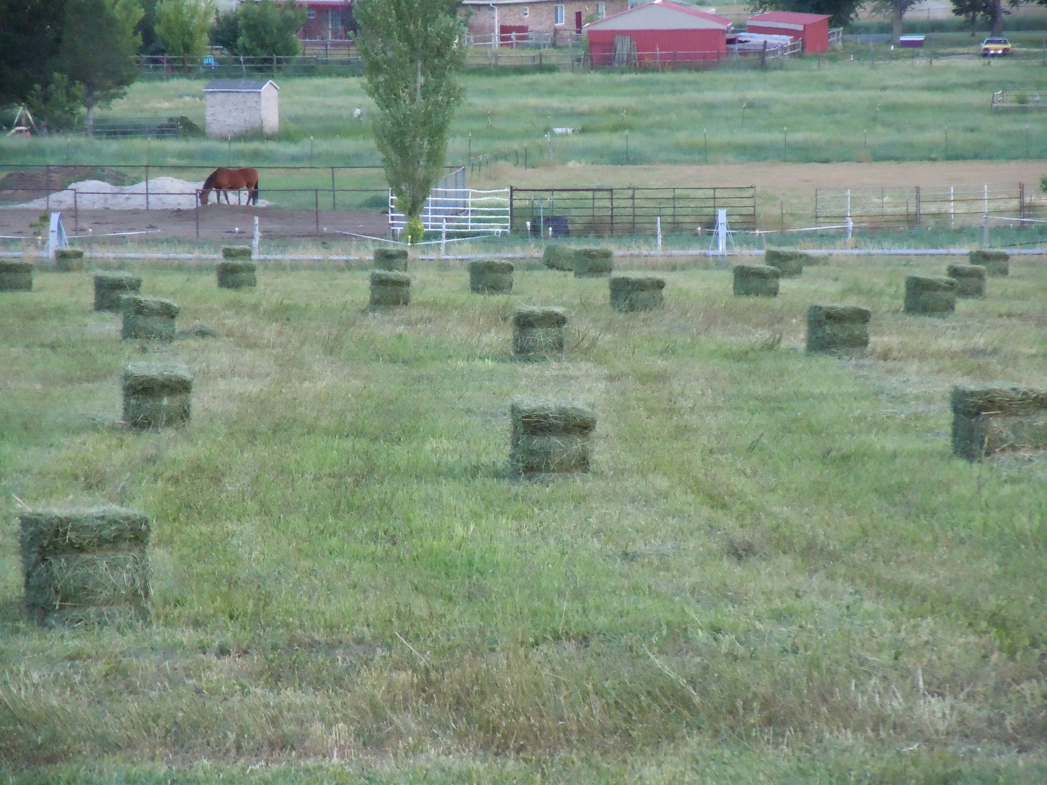

I would have to agree 24 hp too small, I'm using a 35 hp "chinese" 4 wheel drive tractor and is probably the smallest for baling. I'm probably the king of small baling and I mean Small as some of my fields are 1/3 acre. Some I only get 5-6 bales off of. There is any one in the area that would fool with cutting raking and baling that minuscule amount. The people I do it for think it's Gold. Yes, This is my retirement equipment like the fellow above stated. My hay machinery is a Jinma JM354, a Hesston 4550 inline small square baler, a SFI 2555 drum mower , a Morra RM280/8 rotary rake, and cone style spin spreader. The whole show is roughly $20,000. Now, I've had start my field from scratch which meant spraying weeds, plowing discing and rototilling and planting and waiting till the following year for a crop, instant gratication it ain't. Now, if you ever go and "try to sell" any hay be sure to have a answer for the folks that want to know if "is it horse hay?" I'm not selling hay anymore. bjr
