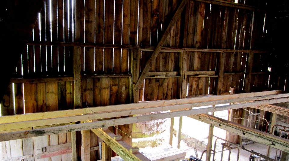

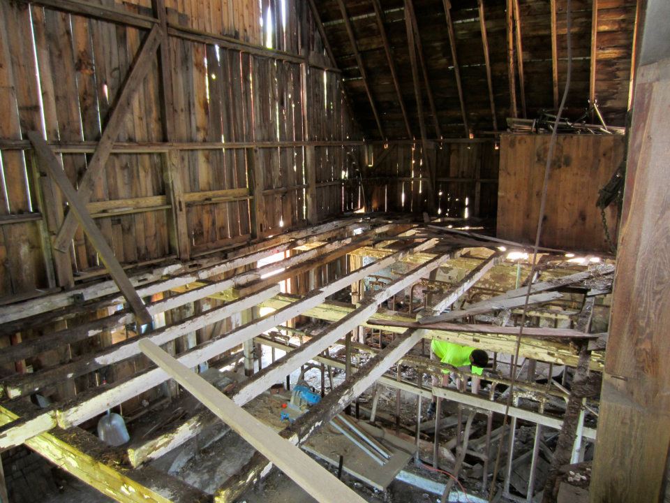

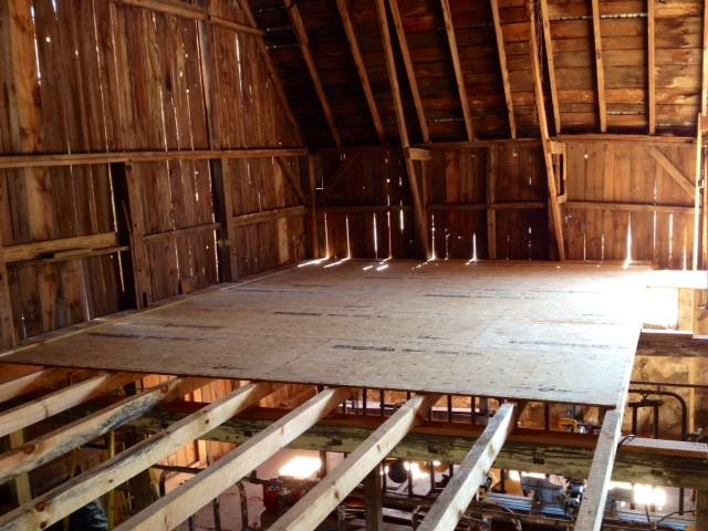

I've been tinkering with our old barn for a few years now.. We had a local saw mill cut the same sized 3"x5" floor joists that were in there (2' on center) and we're using 3/4" T&G AdvanTech plywood..One side is done now and it feels very strong..

PRF- may I ask how you hung your joists? Our joists are still solid (unless post beetles know better), and they were nailed to the 4in portion of the true 2x4 studs. The (2) nails are immense, and more of a spike than a nail:laughing:. I need to research if this is proper for load bearing, or if hangers should be installed.

We just butt joined them on the 6" wide beam below and used a framing nailer to toenail them in.. It's not going anywhere anytime soon.. At the ends we used joist hangers to tie into the sill.
