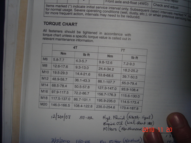

Not sure if this will help, but perhaps... This is a general torque chart from the M-F service/owner's manual for my 2310.
"M" size refers to the metric thread size; the "4T"/"7T" I'm guessing refers to steel type/hardness, but I don't know enough about that to clarify. Perhaps one of our metallurgist members can help out here.

M10, M12, M14 are the bolt sizes. ie; M10 is 10mm across the shaft of the bolt.
They should also be marked with the grade of steel, either 8.8 or 10.9. and then sometimes the length in mm.
You torque the fastener as per the specs you listed, although the wide range for each seems kind of vague.
You obviously want some kind of thread sealant for any fastener that is open to coolant or oil.

Well I can find no reference to a grade 13 bolt.
There is certainly a difference between an 8.8 and 10.9 grade bolt.
So my answer is, I have no idea what the 13 may relate to.
However, the measured diam tells me the safe torque range for your fasteners is 47 to 50 ft lbs.
When you torque the bolts, you will increment up to those numbers. If the bolt keeps stretching, stop! And replace them all.
