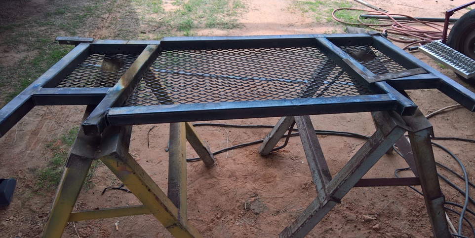

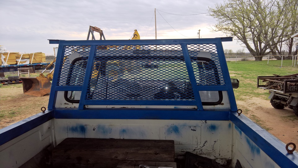

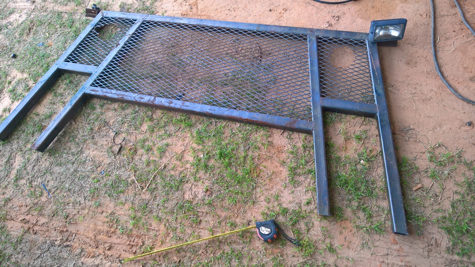

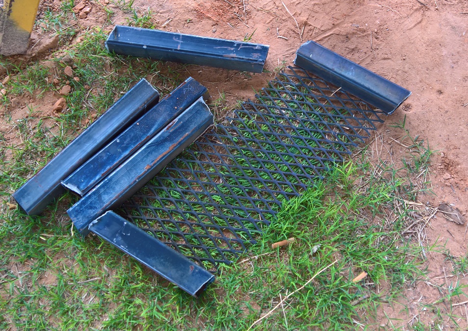

First off it is an old beater of a truck but runs great perfect for use around the farm or going to town and back for supplies but it needed protection for the rear window so I cut the headache rack window guard off of a flat bed I have which came off of a larger truck then cut it down to fit the pickup, Here are some pictures of it
As cut from the flat bed
The removed bits
Modified

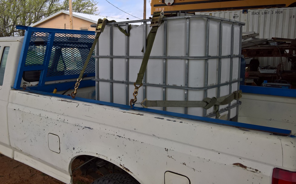

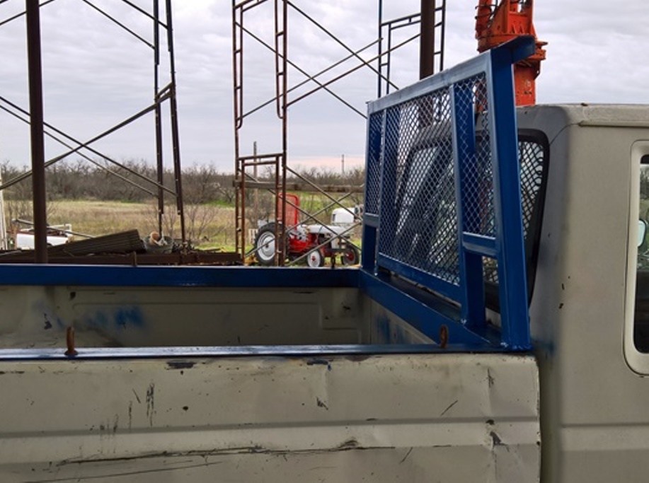

then I bolted 3 x31/2" angle iron to the bed sides and welded the rack to them
I used 1/2" electric motor lifting eyes as the bolts to anchor the rack to the bed under the bed side rails I used lengths of 3/8x 1 1/4" flat bar as stiffeners allowing me to use the eyes as heavy duty tie downs

I'm pretty sure that bit of blue bar left hanging off the top ends would give me a headache right quick.

I like how you incorporated the side rails for the eye bolts.
Curious though what ya' gave for the truck.
Yeah I guess you could of you are 6'5" tall and have a habit of leaning up against the cab those bars don't extend beyond the width of the bed.
