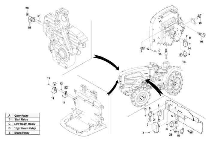

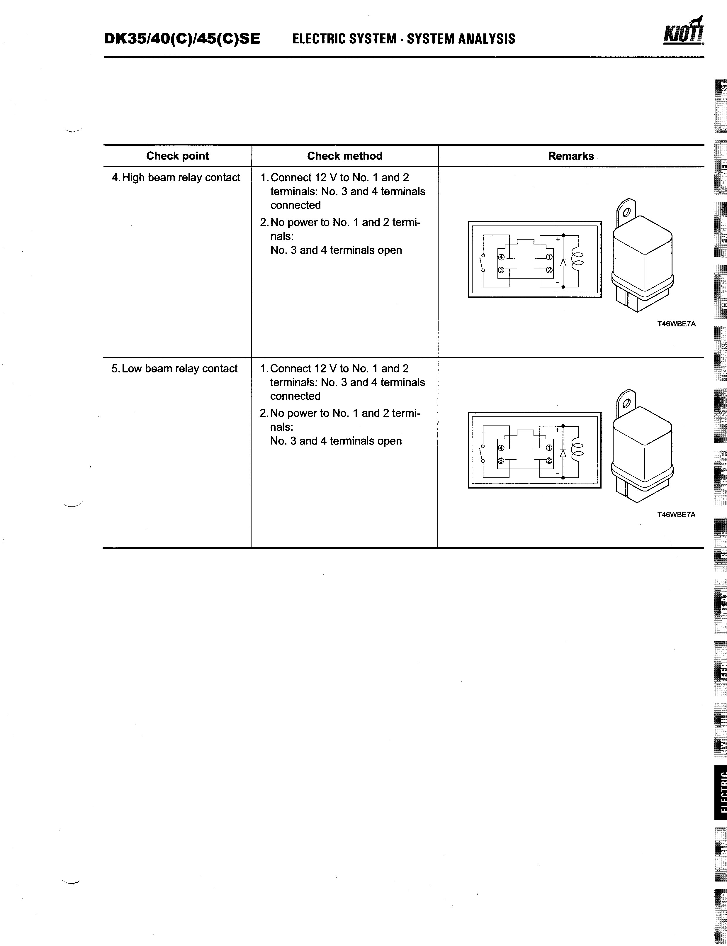

I would like to know if both low and high beam relays on my CK35 kioti could be blown? How do you test the relays with a vom? We have voltage to the relay plugs of both. We have spent a lot of time troubleshooting this problem. Maybe a wiring schematic would be helpful. Any response would be greatly appreciated. I just now became a new member and look forward to chatting with a lot of other tractor owners. Thank you, Boogle.
   / headlamp problem #2
   / headlamp problem #3

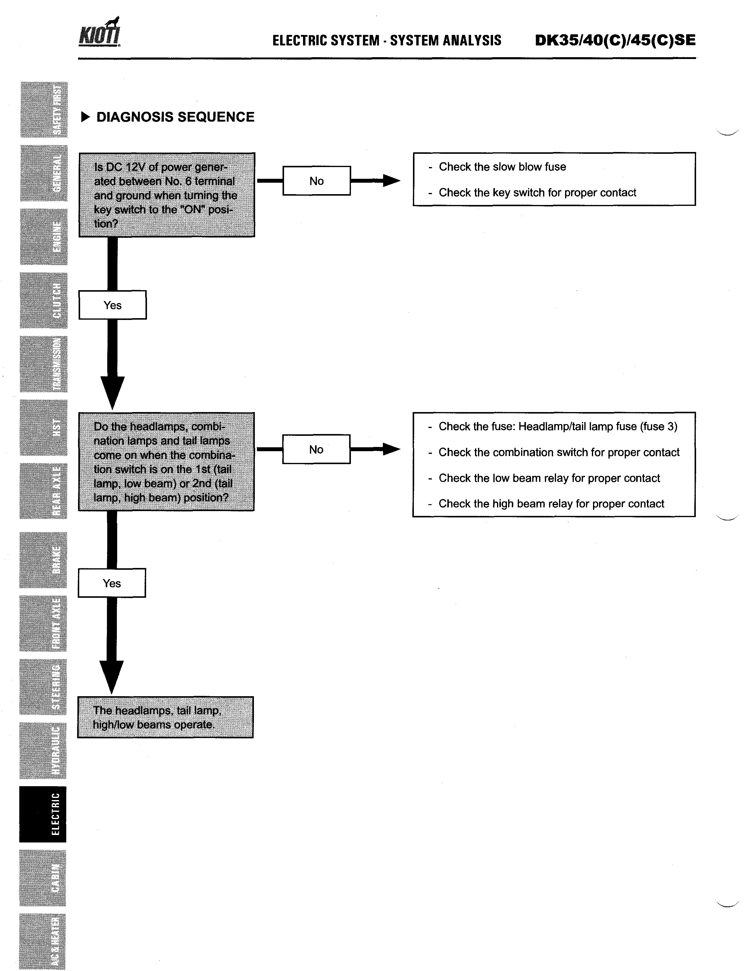

Here's what I have for the relay location. You say you have voltage to the relays. Is this voltage the 12 volt supply to go to the lights for when the relay closes or the 12 volts from the headlight switch to energize/close the relay? I'll check my manual for a wiring diagram.
   / headlamp problem #4
Did you check headlight fuse? Ground wire to the headlamps?
