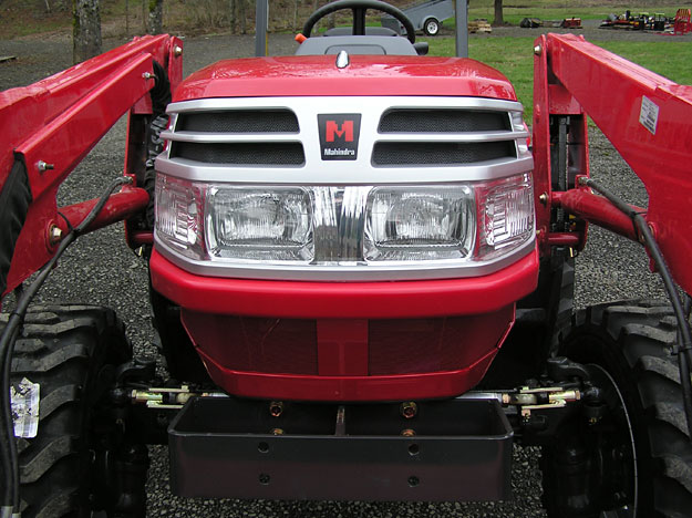

Here is the new Mahindra grill used on the 3215HST with headlights that look like they would produce more light.
Sharp looking grill

   / headlights #7
I agree. A lot of tractors have headlights in a similar location which is not much good when you need to raise the bucket to go somewhere which then blocks the lights and its not a good practice to raise the bucket above the lights and drive that way. The lenses on mine also seem to diffuse the light instead of focusing them in a beam. My 2615 is no exception and I hardly use the headlights. I mounted a HF $15 pair of driving lights up high to my homemade cab / canopy and one on the ROPS with a 2" squared U-bolt for a rear work light. I may build a front grill brush guard for mine this spring and when I do I'll get a nice set of lights to mount on top of the guard.
