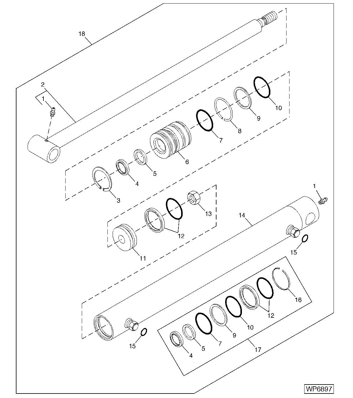

was dragging backwards with the JD loader bucket on my 4600 curled under, hear a bang and now the bucket will not curl back up just hangs there , could i have possibly broke one or both of the cylinders. Any idea as to where to start checking, my tractor is in good shape a lot of hours on it , does the loader bucket need both cylinders to curl the bucket, about yr ago had to have the value body on the controll stick replaced.

Sounds to me like the cylinder packing(s) are blown. You can confirm this by disconnecting the quick couplings at your actuator valve (for the bucket curl) and see it the bucket still flops. if it does then cylinder packings. If it doesn't then valve packings.

Disconnect/unbolt one of the cylinders and see if the other one will operate. Then disconnect the other one and see if it will work. You may have just popped the nut off the end of the shaft. In that case, you might be able to pull the shaft out of the cylinder.
You can also disconnect the hoses from the cyl and put plugs in them and see if the other one will operate.
   / hear a bang jd loader bucket will not curl #9
G'day sorry to say but the bang you heard could be the piston on the end of the rod disintegrating i would pull both the cyl's off and strip down, alloy pistons have shattered before and sent bits of alloy through the hyd system. If you find one broken make sure that you change/clean any filters in the system good luck:)

Your problem definitely sounds like you broke the cylinders, possibly the nut stripped off the rod...
If you are close I would be glad to help you....
