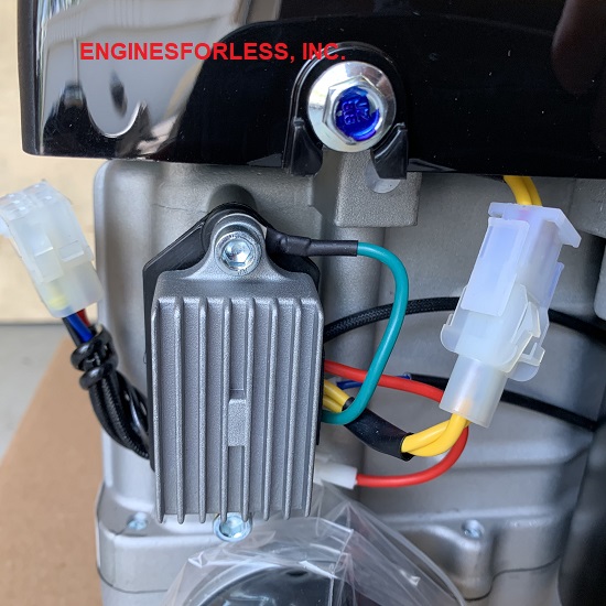

Please help me determine how to apply the two red wires off of this engine's harness?
I have this mower wired minimally.
Just a simple battery charge off of engine, push putton start,
toggle switch for pto, toggle switch for kill.
That's how the briggs was installed.
The Loncin has a simple four pin harness emerging from it.
Please help me determine what to do with the two red pins/wires in the
harness pictured at the left of photo
(red) Hot 12v, (red) hot 12v, (blue) fuel solenoid 12v input, and black ground.
Are both the reds the same? does it matter which one is used to charge the
battery? Is it a direct connetion to the battery?
What exactly do I do with the two reds in addition to that? Is one for accessories like
lights?
Finally, where is a 20A fuse supposed to be placed in this very simple wiring setup?

Engine manual might have those wires in a description listed in the electrical section (which would have ignition, charging, fuel solenoid, etc). Have you tried the manufacturer web site for engine manuals (owners/operators, parts/diagrams, etc)?
Engine
Easy enough to find. Have attached what is available from the China site.
Look at page 10 in the owners manual, electrical diagram, (Plastic connector) both of those red wires are DC power out from the rectifier (available for powering or charging), the black wire is the engine kill wire, yellow is to power fuel shutoff solenoid.
Also that engine must have a 90 octane gas no methanol fuel!
There is no documentation on the charging circuit as to it's ampacity (total current output), but since it is a split in the circuit to two wires, both need fuses, fuses are used to protect wiring and the charge circuit. The one for the battery should be 20 Amp, the other should be 20 Amp or less (both depend on the wire gauge used in the circuit).

but essentially, according to the diagram from the manual you linked, the two red wires are pretty clearly just forked off of the same source. They both serve the
exact same function. Correct? Why would they even put two identical hot wires in the harness?
It offers options to the tractor/equipment manufacturer or end user on how to add options for being powered. Offering 2-20 Amp circuits versus 1-40 Amp (wire and connectors sizes are reduced therefore more economical).
