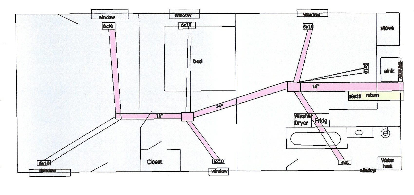

Hey gang, we have a apartment that is attached to the back of our garage. I got some quotes for central heat and air for the place and was blown away at the cost! The place is 792sf measured on the outside. The walls are cinder block with a layer of 1" layer of foam board and then sheet-rock. We currently have window units and electric baseboard heat. Our current tenant is elderly and the cost to heat is crazy! I have gotten quotes between $7800 and $8700 to put in split central heat and air(gas heat). Another contractor said that there is not enough space in the attic to go with a split system and wants to put in a packaged unit. I had looked at the packaged units before and did not really like them because they are so large, but these prices are making me wonder if I should put one in myself. They do not require messing with the refrigerant because they are self contained outside.
My big question is the duct sizing. What do you guys think of this plan? Most of the register are 6x10" and are feed by 6" duct. The main feed is 16" and then reduces down to 14" and then reduces down to 10" for the last room.
I believe I can save between 3 and 4 thousand dollars by doing this myself.
Any help/comments are much appreciated.

I would think a contained unit with proper return and then flexable duct to rooms. Length of less then 20 foot each. all could be done by yourself.
Don't go to small on the return unless the sound of a jet plane isn't a problem.
We just installed 2 contained units in a church fellowship area 40' by 80' and 16' high. return duct of about 4 feet length and the 24" square for filter. The cold air about 8' up the wall then register to direct the flow. Soon found out the 2nd unit could be shut off soon after starting . admazing how quickly the room cooled.
With your rooms of approximate 40X20 ' total
Go to a a/c supply and discuss with them the need usually willing to help in a plan.
Labor is the prime expense in installatioins.
ken

   / Heat and Air Duct Advise #7
I've been doing HVAC for 34 years now....
all this to say...in all that time I can remember maybe 2 guys I would trust with duct design. Some can help on equipment selection as they have had seminars etc put on by different manufacturers. But still...its kind of like going to Pep Boys and getting mechanical advise. If you PM me I'll do my best to help you out

#9
What does a load calculation involve? This is just a 800sf building, can it really be this difficult?
Help
DAve
   / Heat and Air Duct Advise #10
Help
DAve
Not that difficlut but, it's not plug & play either. Load calc, cfm, flex vs metal, etc,etc,.All of this is usually taken into consideration. It Just depends on how well you want it to work. Usually, you would know CFM'S friction rate , etc,etc, to size the duct work
