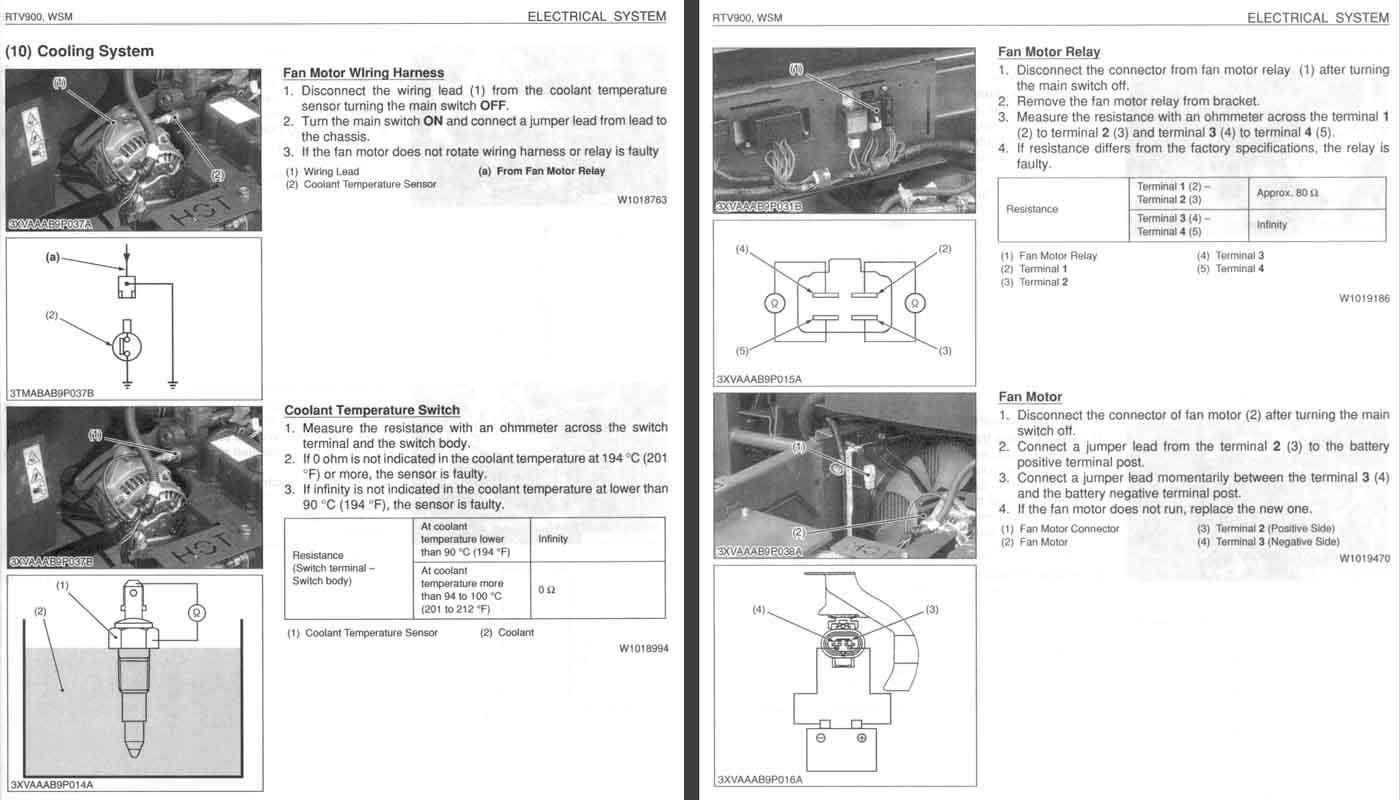

Tomah,
Welcome to TBN.
What you're seeing/experiencing with the RTV temp is pretty normal. Unless working the machine hard, I rarily get a temp reading.
Here's what I got from the dealer (I believe it's from Kubota to dealers).
"Since its been getting cold outside we have been getting calls about the temperature gauge not working. The RTV has a large metal transmission and a heavy cooling system in the hydraulic loop. This holds the temperature of the engine and tranny down for a rather long time. Expect at least 20 minutes of run time before seeing any movement of the needle (170 degrees)."
I thought it was already posted out here but can't find it.
Attached is a document outlining the steps to test the cooling system. I too was getting no reading and the fan wasn't kicking on so I went through these steps and all checked out fine.
I think with the temp gauge starting at 170 degrees, you have to work it pretty hard to get it to that temp or higher.

Thanks for the reply on the gauge problem both of you guys.
I guess what you are saying is Kubota puts in a thermostat that opens lower than 170 degrees which is when the gauge starts to read.
The thermonstat should not open until the engine temp. reaches what ever is in there for a thermostat, so if it working right it has to be lower ten 170 degrees.
The capacity of the radiator and transmission should not effect the engine until the thermostat opens and lets colder water in.
The other thing that I can not understand is that I get some heat out of the heater without any reading on the gauge and the heater hoses are on the open side of the thermostat, so that may be the problem that the thermostat opens before the gauge starts to read.
I will install a direct reading gauge on the engine that starts at zero to 200 degrees and see what the engine runs at under normal operation and when the thermostat opens.
On the 12 cyl. Cummings that will not heat up, I am not sure that you have one or not, but make sure no one installed a block heater on it and connected one end of the hose on the block and the other end beyond the thermonstat housing or into one of the heater hoses, that way the hot water circulates through the radiator and can not stay in the block and get the water hot enough to give you heat, and give you a reading on the gauge. The engine will not heat up because it is circulating the water through the radiator all the time. it is like not haveing a thermonstat in the engine. I have seen this happen three times two Detroits, and one Cat.
Thanks again for all the help.
