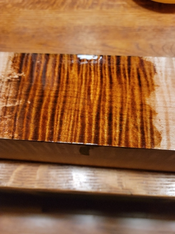

I'm going to get some Maple wood. Use some Ferric Nitrate on it (some kind of liquid with suspended iron dust as I think I read) and see if I can re-create this. To get the reaction in the wood, I understand it has to be heat treated, hence the gun.
My hope is to make a wooden box out of this. Seems it interacts with the tannens that are in the maple wood. Otherwise, I have no clue. Got the Ferric Nitrate on way, need method to heat to experiment.
I really like that finish.
