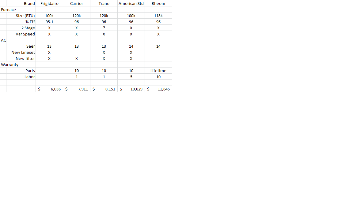

I am looking for a new heating and AC system as my 23 year old Bryant is starting to have some problems. I am looking for advice and please keep in mind I live in NE Indiana.
I have ruled out geothermal as we have Natural gas already. With the prospect of electric rates going up and the current cost of gas it is the lowest cost way to go.
Here is a summary of the features, sizes, and costs that have been recommended for my house.
View attachment Furnace comparison.pdf
Thanks in advance for your thoughts!

Sorry guys. The PDF opens for me. This format may work better.
   / Heating/Cooling Selection
The Trane dealer is the company I have worked with for about ten years. The couple who owned the shop just sold it to their technician who we have liked through the years so my initial thought is that it was his business to lose. The Frigidaire is from another shop that is a guy and his son. but the other three are from much larger businesses that I have not worked with but they have good reputations.
I know the Carrier is made by United Technologies which also makes Bryant. I have been happy with my Bryant but the only dealer in the area is one that sold it to me who I will never go back to again. I agree with the comments about the installer as after a year of my other one I paid another company to re-install the one I have and it has been great since. That is why i went to the reputable Carrier dealer for a quote.
K7LN - I understand your comments about complexity and that is my worry as well but even the technician I have been using says that the VSM would make a big difference in comfort. He is certainly not a salesman and a little bit of a hillbilly so if even he says it is worth it it got me thinking.
Shui - I am surprised at the recommendation of 16 SEER since you are up north and do not use your AC as much as someone down south would. How long is the payback for that upgrade? Aren't heat pumps a lot more expensive than just AC units? Your comments intrigued me.
SeaBee - What does the "condensing" type mean? How does it differ from a regular gas furnace?
thanks again for your comments!

The issue is maintenance as you're going to have to hard pipe a water line to the humidifer. The two top choices for parts and availability that your contractors would be familiar with are either Aprilaire or Honeywell. Personally, I'd only use a Aprilaire as Honeywell has had nothing but issues over the years with theirs. If your contractor offers Aprilaire, ensure that they know they need to run 220 to the unit as most guys only want to run 120. The difference is the 220 offers a higher output for steam and guys who only run 120 generally have to eat the upgrade because they only ran 120 to the unit and the homeowner isn't happy with the output.
Most guys install a bypass because they're cheap and make a nice "add on" at a low price. Bypass's don't do jack except make you think you're getting some humidity in the air.
FYI - PSC motors in furnaces are going to be going away in the near future. SEER ratings from all the manufacturers are limited with a PSC motors.
Looking at your file, I'd ask the Rheem and American Standard quote who is covering the extended labor? It's either in house or third party, and if it's in house, you're only limited to using that same company for warranty work.
