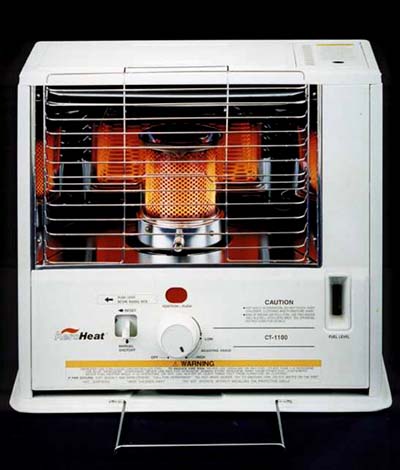

Back when we had a mobile home, we used to supplement with a Kerosene heater. It worked well.
