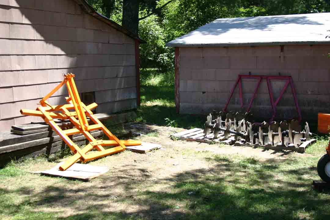

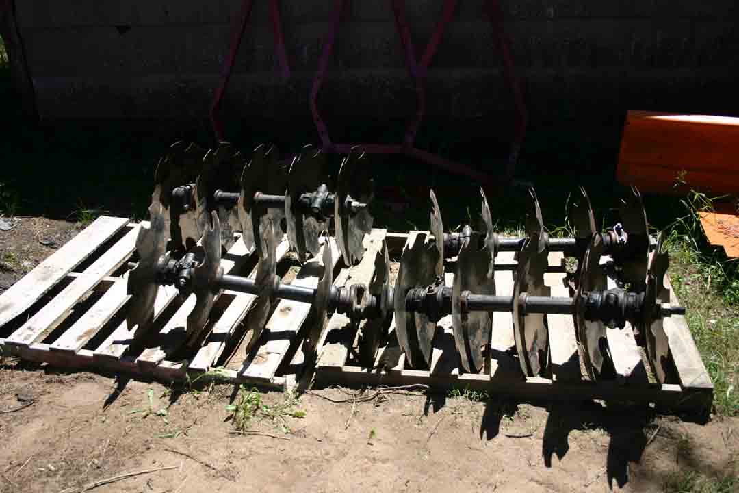

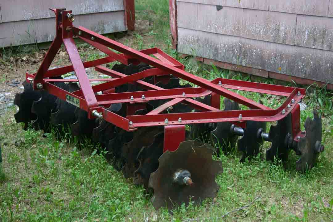

I've been lurking on this web site for quite sometime and thought I would contribute something. I bought a disc that was made with angle iron for the frame. I was disappointed with as it would bend so easily, so I decided to make a frame that would hold up. Tired of straightening out angle. Here is old disc.

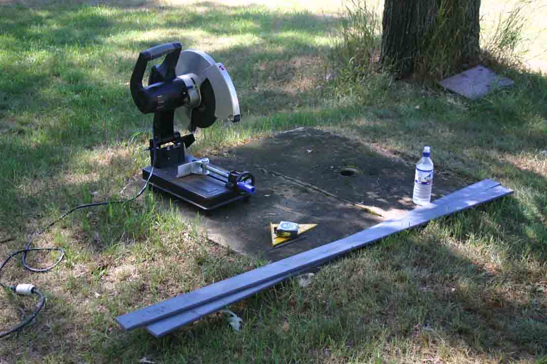

Try again to show cut tubing

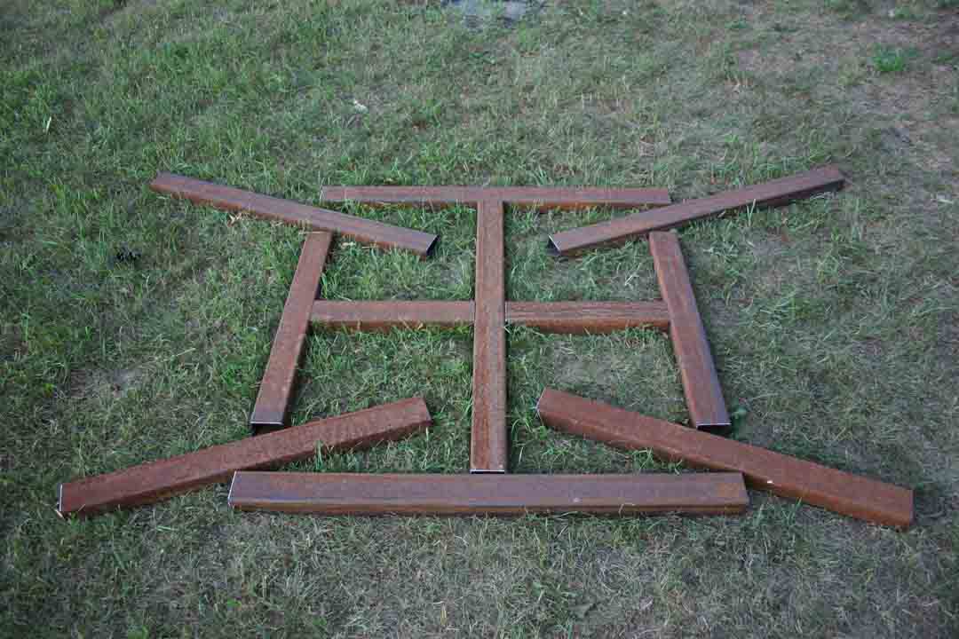

   / HEAVIER DISC
HERE IS FLAT STOCK BEING CUT

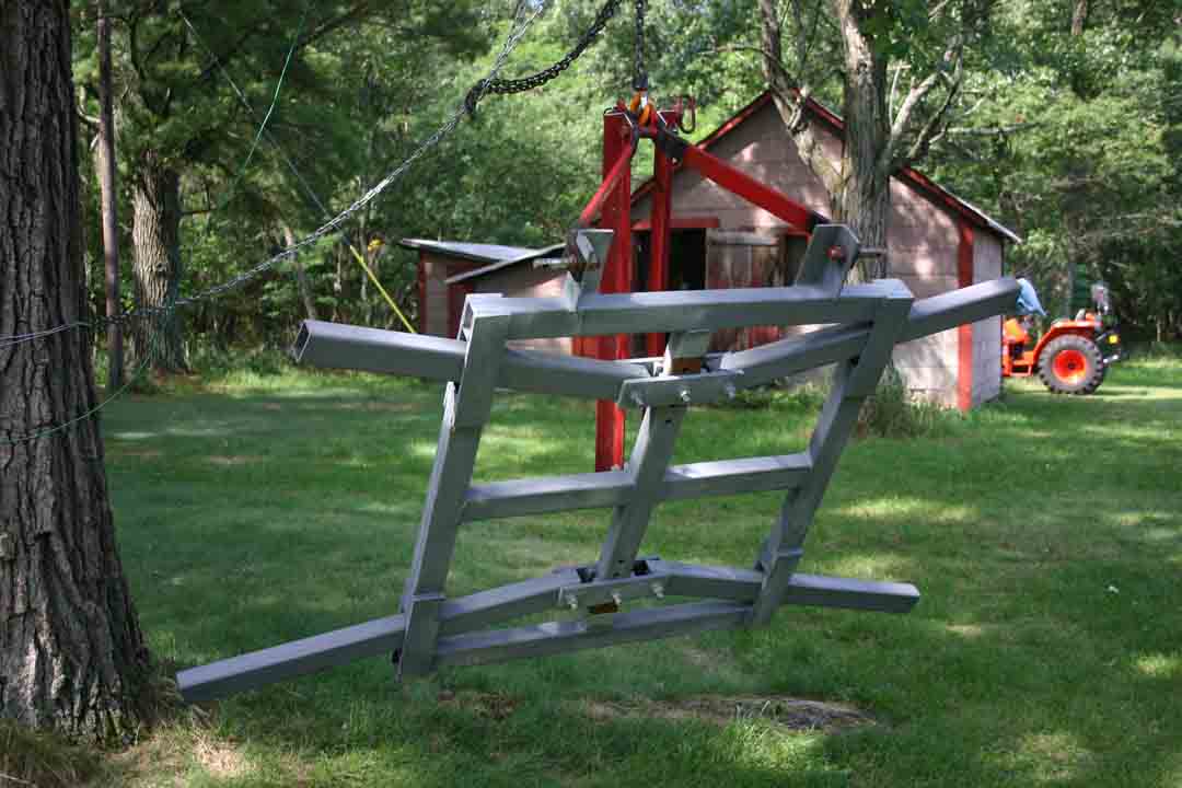

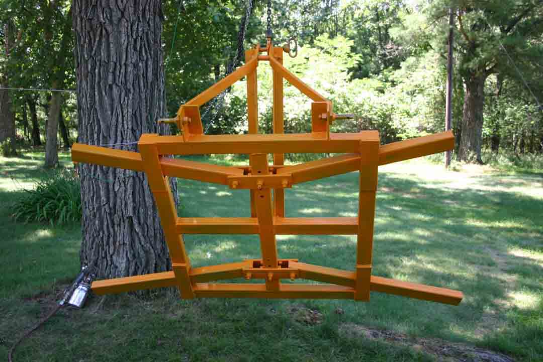

Here is welded and primed
   / HEAVIER DISC
Here is painted frame

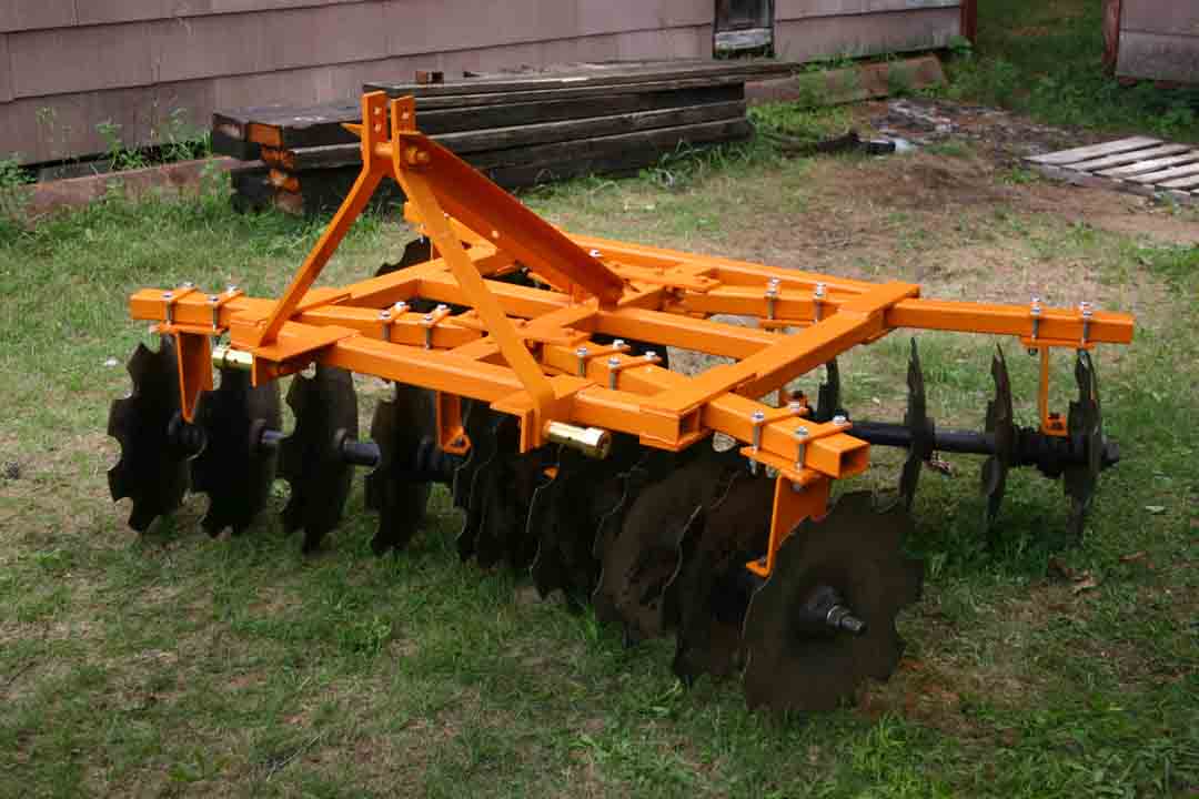

Welded and painted ready to put axle and wheels on

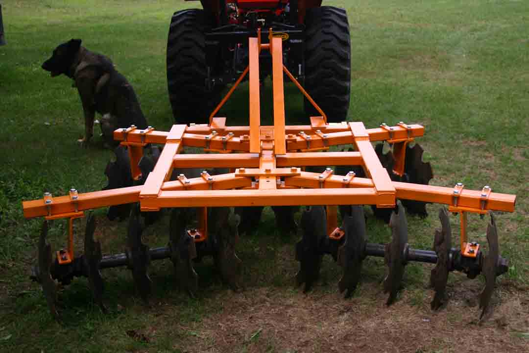

Rear view. I am quite pleased with this setup as it is heavier to dig in more and has not bent at all.
