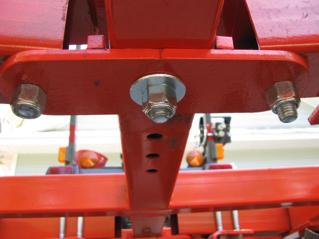

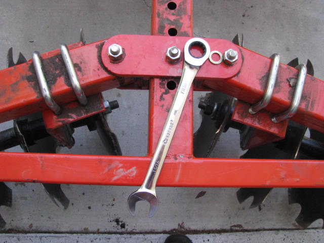

Howse has the most common method of gang angle adjustment with manufacturers: three bolts clamping a friction plate to adjust each gang. Cheap to manufacture, works fine, simple, 20-30 minutes to adjust two gang angles. I recommend buying a ratchet equipped wrench to speed nut loosening/tightening.

I enlarged the picture of Armstrong's Heavy Duty Disc Harrows. They have an "open" draw pin, not robust enough for me, for discs of published weight. I prefer a double clevis, to accept separate draw pines; two ears distribute the draft force. Picture is dropped Double Clevis on Howse 16/18".
If you look at the current photo on my first post, you will note triple clevis hitch compatible with both CAT 1 and CAT 2 quick attach. The picture on the WCT site is obviously out of date.

I wouldn't be too concerned about the screw adjustment vs pins for gang settings. I rarely have my disc set for less than maximum gang setting for maximum cutting/tilling. Maybe once in 2 years do I roll it back for just covering seed in the pasture and it isn't that big a deal. I do it at my shop with an impact gun to loosen/remove the bolts so it is not a big deal. I would rather have the holes to gauge the correct front and rear gang settings than have to measure the screw length each time or continue to turn a bit, disc, turn a bit more etc till I got front and rear cutting the same. Regardless of adjustment bolts coating, it is going to rust over time and be hard to turn or freeze up. At least with the other type, bolts can be cheaply replaced if they rust up, twist off etc.
