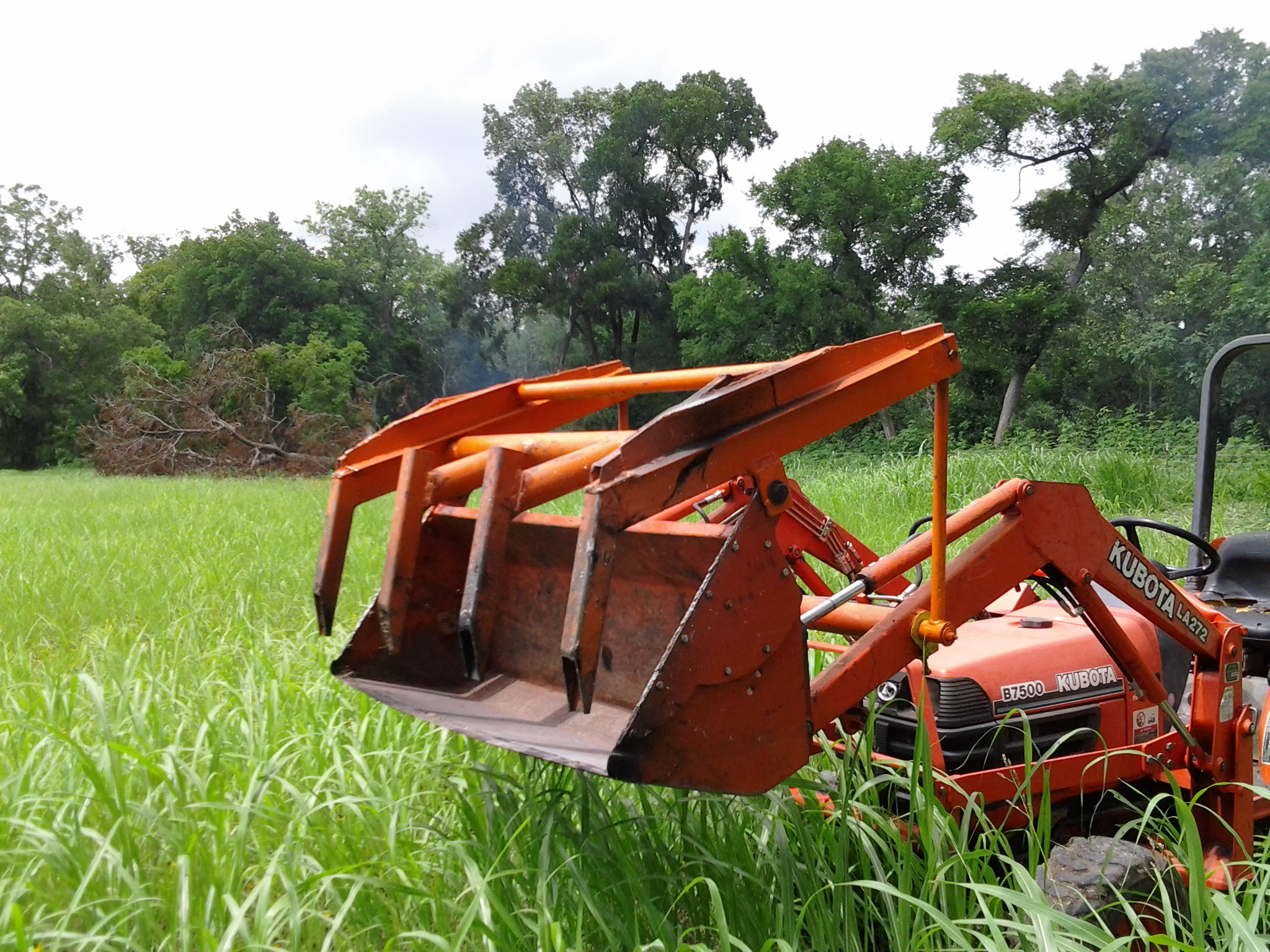

Here's a pic of the grapple I designed which uses the position of the bucket to grasp objects.
The grapple essentially stays in position relative to the loader arms while the bucket rotates.
It has a tremendous grip.
The ability to lift large diameter logs would be improved if I added some teeth to the edge of the bucket.
Earlier version which succumbed to destructive testing
The limiting factor on what it will lift now is the size of the loader arm cylinders.
The orange version could probably loose 50 lbs with a design change which started from
scratch but hey it works just fine the way it is now.
One great thing we do with it is back-drag like a rake. It clears out briers incredibly
well as well as mashing smaller brush. You have to be careful picking stuff up because it will snap 3 inch limbs.
I like the fact that closes tight so you could carry 1/2 inch rebar if need be and it wouldn't fall out.
