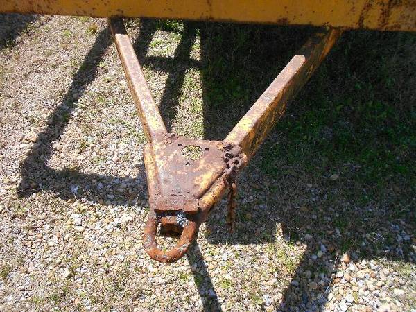

I've hauled more hay on something like that than I care to think about, looks OK built to me, hard to tell with pics. I am a fan of MH axels for farm (low speed short haul) trailers. They are fairly rugged and I have had very little trouble with trailers 20+ years old. Not saying I would use it to move equipment every day.
   / Heavy Duty Trailer #4
Looks like it has all the important parts and priced right!!
   / Heavy Duty Trailer #5
The poster might be confusing equipment axles with MH axles. ??
It is probably a good deal but does need work.
   / Heavy Duty Trailer #6
It looks like it could have been a factory trailer but what's going on with that tongue? Mine has a ring that can swivel. That ring almost looks homemade.
   / Heavy Duty Trailer #7
The ball socket has been cut off the coupler and a round-bottom "V" of heavy rod has been welded to the sides of the old coupler.
Bruce
   / Heavy Duty Trailer #9
Bruce
<img src="http://www.tractorbynet.com/forums/attachment.php?attachmentid=327573"/>
That looks like the worst part of the trailer to me.
