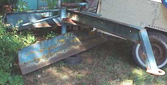

As far as ripping up a driveway with a boxblade, going deeper than necessary to get to the bottom of tracking ruts does more damage than good. I don't use a boxblade, see attachment.
