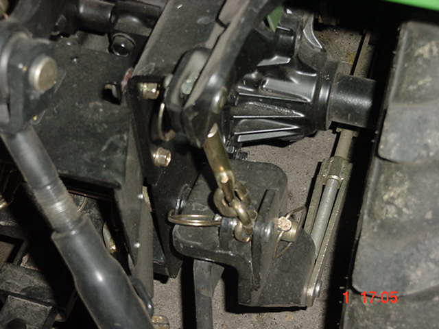

Sorry I have taken so long. I had some technical difficulties with my digital camera. It broke! Here are the pictures of the kit on my tractor of course.

Sorry here is the 1st picture

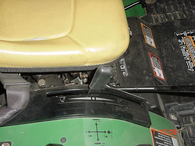

Here's another picture, this one is of the rockshaft lever. There seemed to be some confusion on some other posts about this little doohicky<--technical term there

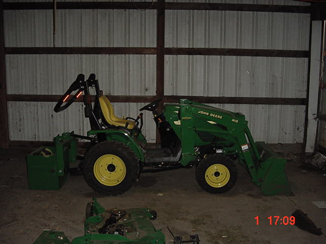

Here she is in all of her glory. (It was raining I couldn't think of anything else to do)
