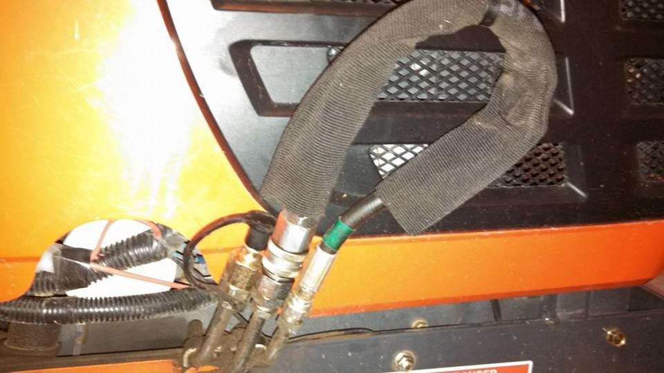

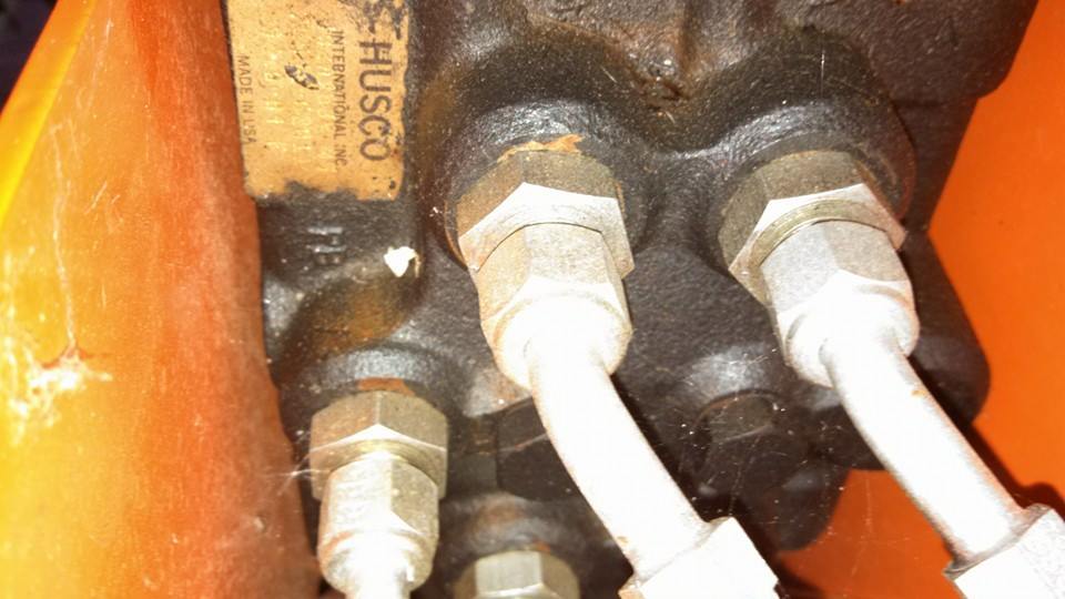

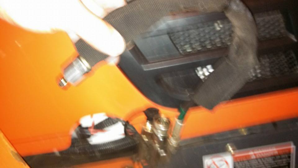

Thanks for talking slow JJ. It's starting to click. Went out to the barn where the loader is stored so I could see how it would hook up to my tractor. The back of the valve is marked PB on the port I'm looking for. There is a hard line coming off that port with a QD on it that the hose from the block plugs into. (right now that hose is simply plugged into the "pump" QD with the loader removed) I think I finally understand how the PB circuit works.
Here are the pics I took. In the second photo the rear capped port is return to tank, center port is pump and front port with hose permanently attached (green tape) is PB and plugs into the rear of the fel valve. So if I hooked the splitter up with the loader not on the tractor, I'd simply hook "pump" port to the in port of the splitter and the "tank" port to the out port on the splitter?

   / Hello! Newb with that age old log splitter hookup question. #6
Assuming here both the tractor and splitter are set up for an open center hydraulic system?
   / Hello! Newb with that age old log splitter hookup question. #7
It is not a good idea to put QD's in a pump line because if the QD should disconnect for some reason with the engine running, the pump would deadhead and the pump might explode or crack open.
If the loader valve will stay on the tractor, use the PB from the loader valve for the source to the log splitter.
Log splitter OUT/return can go to tank or a return line using a tee.
Do you have QD/s on the loader cyl. If so, that will prevent you spraying fluid everywhere if you touch the FEL levers.
Thank you. I'll take your advice. Since the fel valve comes off with the loader, there are QD's everywhere. (including one on the pump line) There are QD's at the loader cylinders as well but I don't understand why that would keep fluid from spraying if I knocked the lever?
   / Hello! Newb with that age old log splitter hookup question. #9
Since the FEL valve comes off with the loader, I would install a relief valve on the pmp output to protect the pump in all situations.
The log splitter has it's relief, and the 3pt has a relief.
I was thinking if the loader valve stayed with the loader, you might have open work ports, but if there are QD's that the loader cyl plug into, then you are OK.
You can use the same ports for the log splitter that the loader was using.
Ever how you do it, you need a complete path for the pump fluid.
