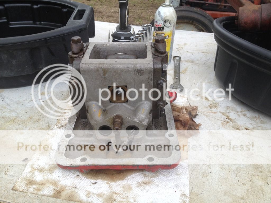

Another beautiful day so I thought I'd start work on the hydraulic pump.
Cleaned the pump with diesel fuel, a wire brush and some paper towel.
http://i351.photobucket.com/albums/q465/carpediem4570/Ford 8N/IMG_3386.jpg
http://i351.photobucket.com/albums/q465/carpediem4570/Ford 8N/IMG_3387.jpg
Pulled the relief valve, the exhaust control valve and the intake control valve.
http://i351.photobucket.com/albums/q465/carpediem4570/Ford 8N/IMG_3385.jpg
I have a new relief valve on order. Do the intake and exhaust control valves need replacing and if so, where can I get new ones? I measured the intake and exhaust control valves and they both measure .592" and have a beautiful fit in the chambers. Chambers look good with no scoring.
http://i351.photobucket.com/albums/q465/carpediem4570/Ford 8N/IMG_3390.jpg
Pulled the valve clamps to get a look at the inlet and outlet valves. Glad I've got new ones on order.
This was the yoke when I pulled it apart.
http://i351.photobucket.com/albums/q465/carpediem4570/Ford 8N/IMG_3356.jpg
After a little welding and some paint and, she is ready to go back into service
http://i351.photobucket.com/albums/q465/carpediem4570/Ford 8N/IMG_3391.jpg
More to come when my parts arrive.
Regards,
carpediem
   / Help 1948 Ford 8N Hydraulics possessed #10
none of your pics display for me.
the cam pin rides the cam on the lift rockshaft.
