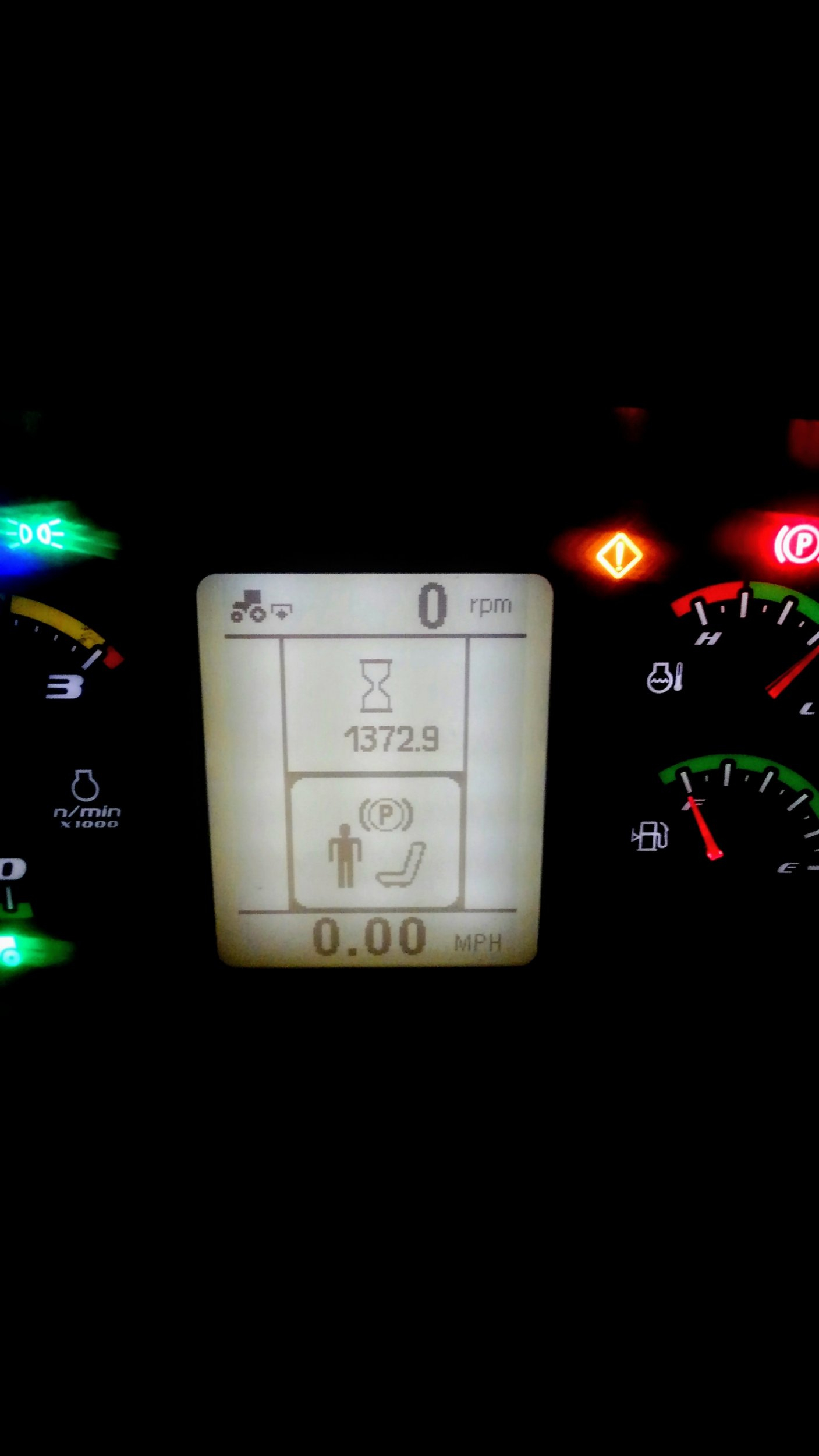

2017 Case 75C
How can I bypass the seat safety switch jumping it out doesn't stop the beeping this is a picture of it with the safety switch jumped out
   / HELP - 2017 Case 75c #2
Maybe it's on a NC contact and the wire has to be lifted instead of jumping it out.
   / HELP - 2017 Case 75c #3
Porkchop, The seat switch was driving me crazy also. My Farmall 65A has 83 hours on it now and the alarm did not go off yesterday or today at all. I think the seat needed to be broken in with use. This winter it usually went off early in its use and then stopped tripping. That made me think cold weather equals a stiff seat springs? As weather warmed up and some use the alarm is not tripping as much and again for 2 days now completely silent.
   / HELP - 2017 Case 75c #4
I don't know your specific tractor. How many wires go to the switch? Some switches simply need a jumper between the wires. Others require the wire to be open to be satisfied. Still others have multiple contacts requiring one pair of wires to be open and another pair connected. Your problem may not be the seat switch at all. It could be elsewhere in the circuitry, perhaps an inline connector somewhere.
   / HELP - 2017 Case 75c #5
the switch is probably a push button type as when you sit on the seat
you compress the switch, I would take a small piece of metal put it on
top of the switch where the button is and compress it and tape it so it
will stay compressed however if you have hilly ground it may be a
safety factor as when you leave the seat the tractor shuts down????
