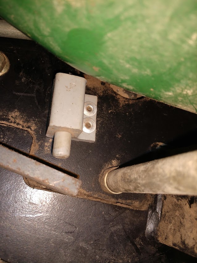

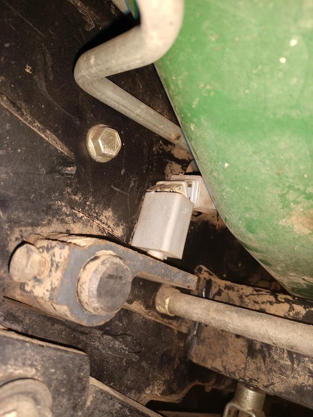

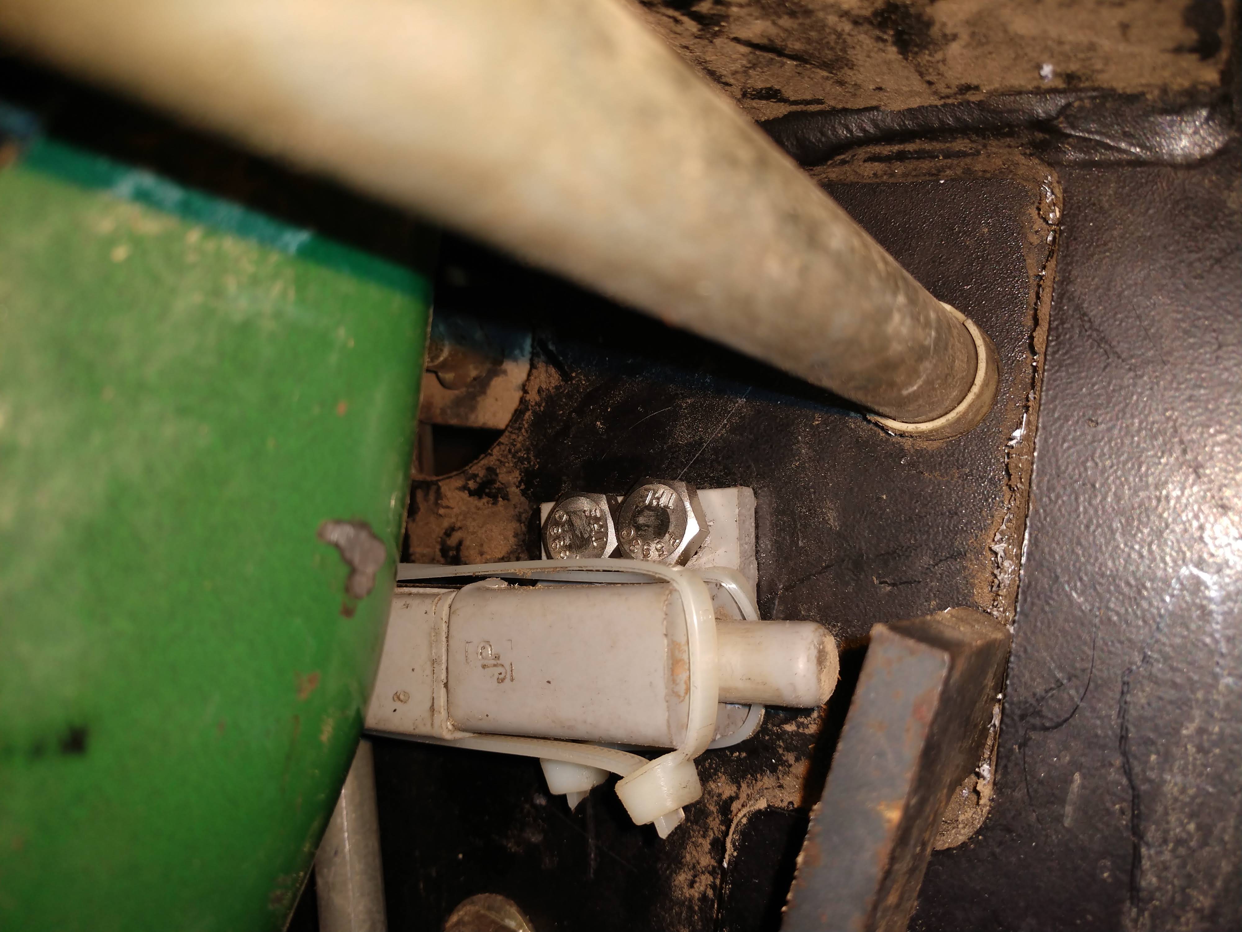

Thanks a million.. it was the brake switch.. must have caught a small branch just right and popped it pretty good. I'll order a new one.. in the meantime I did what anyone with a 20+ year old workhorse would do... i drilled out the rivets, zip tied it back together, put it back together with a couple of SS bolts and back to doing what it does best!
Thanks everyone!
Wes
Broken brake switch
It's riveted in place (it's also plastic)
Zip ties in place!
Ready for action (let's hope it holds up until my new switch get here!)
