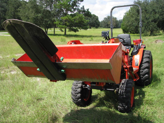

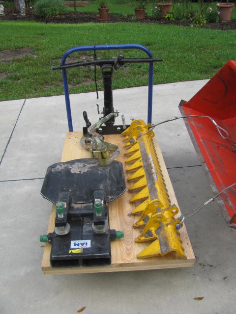

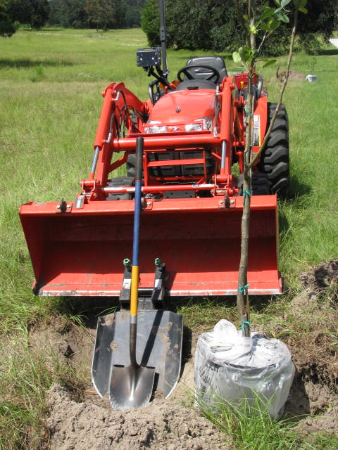

I plant trees with a Bucket Solution's Bucket Spade on my FEL.
Pictures show a Sand Pear tree and Bucket Spade is on my previous tractor, a Kubota B3300SU.

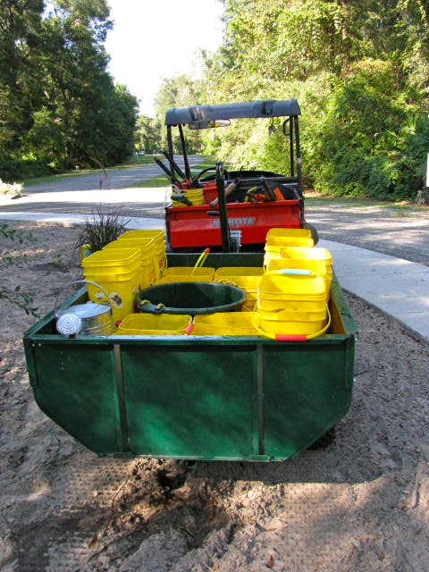

I haul water in six gallon former cat litter buckets, in my MUTS trailer.
