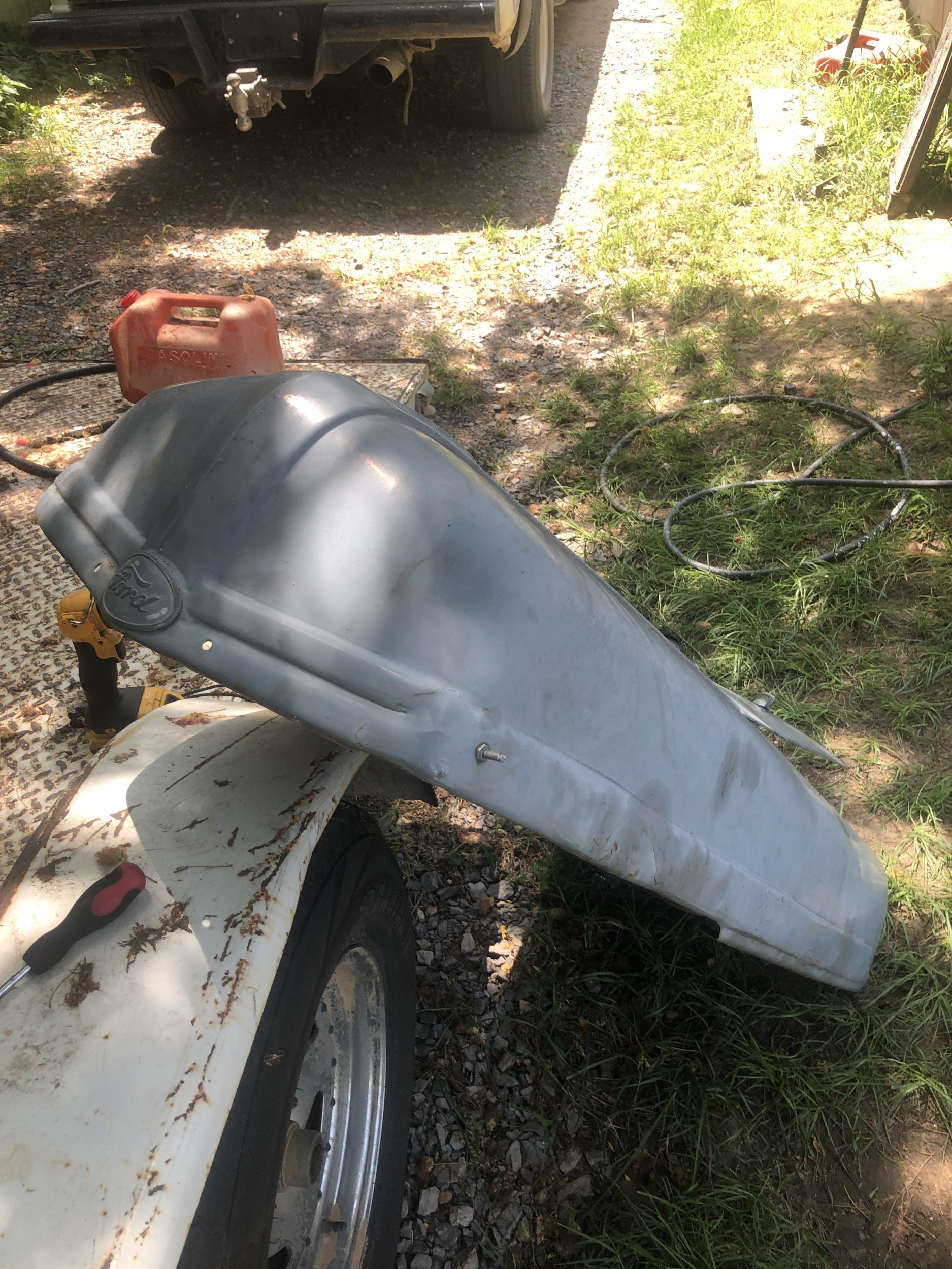

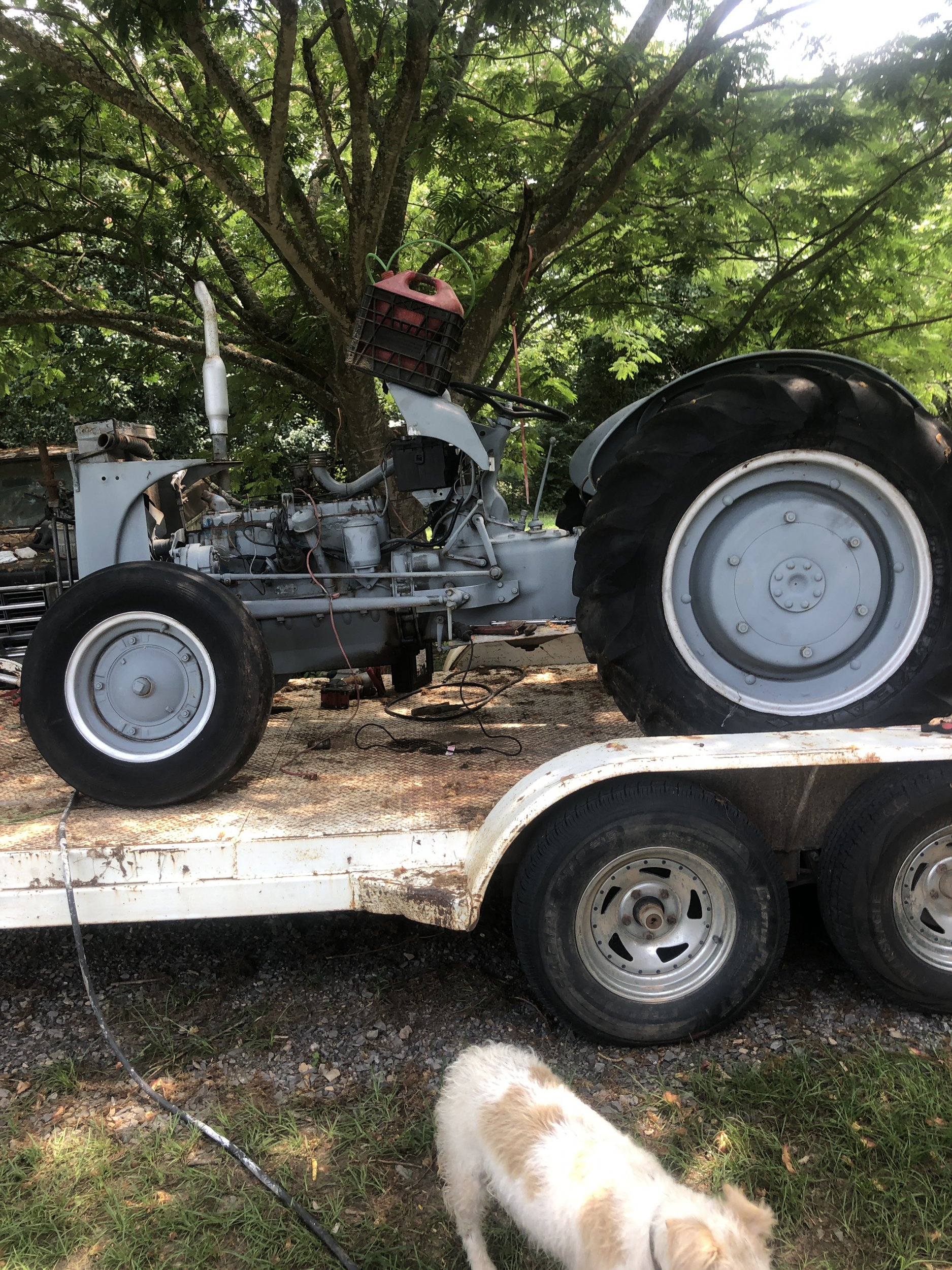

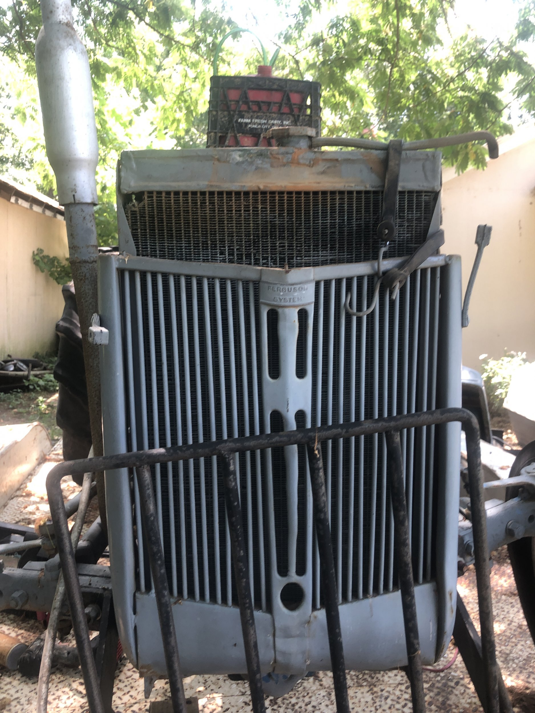

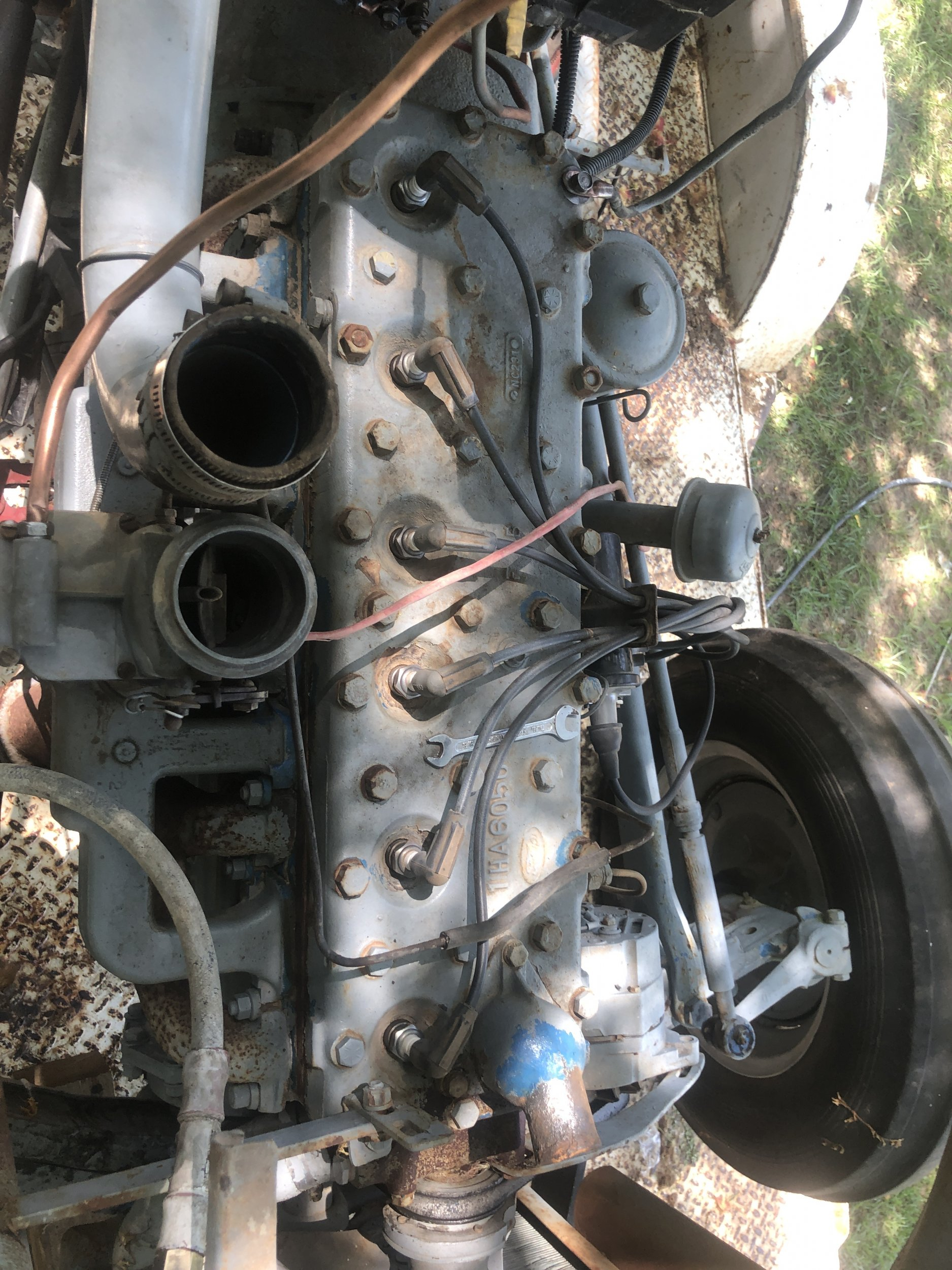

Believe this is bigger than a 9n or 8n. Has a flathead 6 cylinder engine. Number on head is 1HA6050

I'm seeing some stuff on the 'net about a "Funk Conversion Kit":
these kits would allow a 100-hp Ford V-8 or 95-hp inline-six to be swapped in place of the four. It wasn't a straightforward swap, requiring modifications to the hood, the fuel tank, the radiator and a fabricated exhaust, among other things.
Otherwise I know nothing about these tractors at all, though I think they look pretty cool!
   / Help can’t figure out what ford I have #5
It has a 9n or 2n rear end because there are only 6 lugs (8n's had 8), so it is either a 9n or a 2n with a Funk or other 6 cylinder conversion.
   / Help can’t figure out what ford I have #6
The young lady did a pretty nice job explaining it
   / Help can’t figure out what ford I have #7
9N with Funk Conversion
