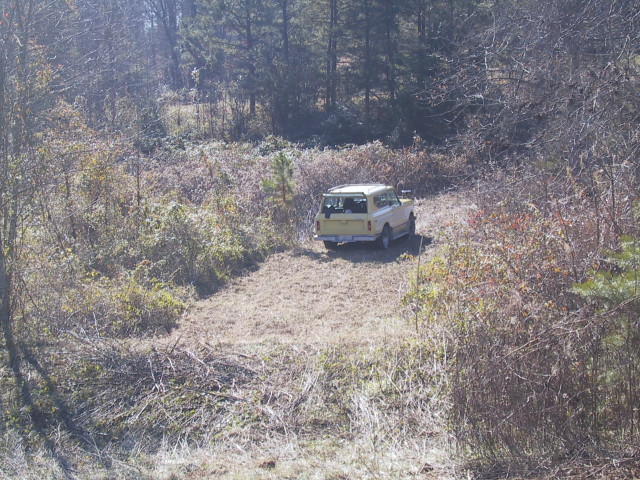

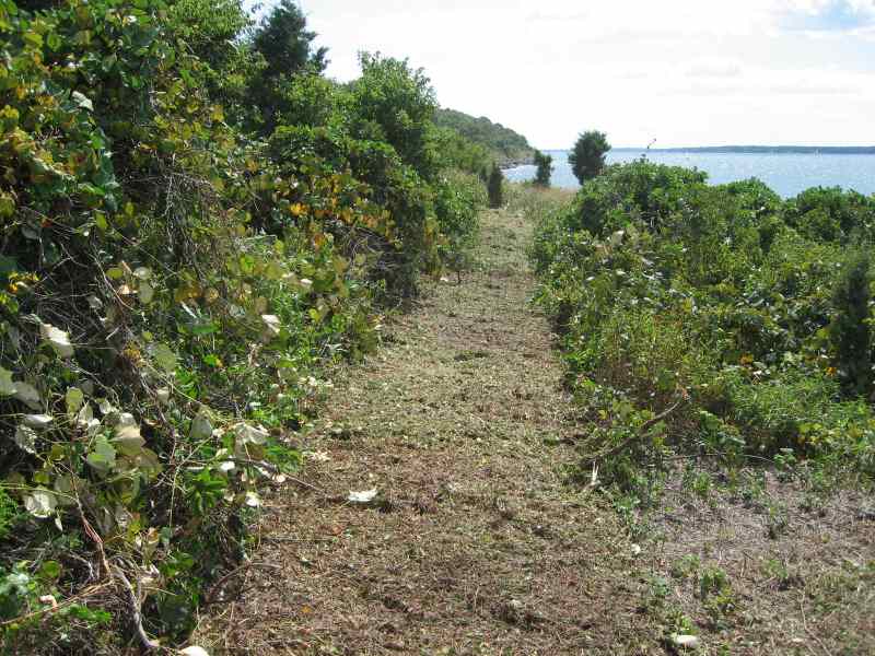

I did quite a bit of clearing brush with a 7ft International Machines(World Agritech) Medium duty mower, and it cuts pretty well too. Here's an example of the stuff I was cutting.

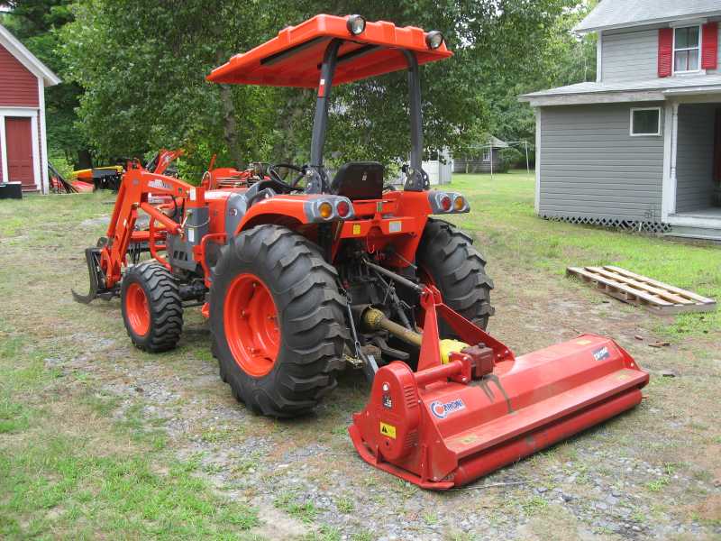

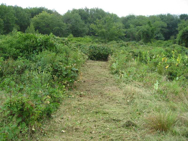

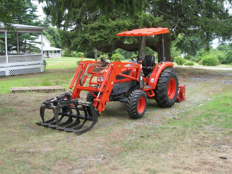

I agree that a 40ish HP 4wd tractor is about the right size. I'd also emphasize choosing a loader that will be strong enough to handle the stumps and bushes you will move to a burn pile. I'd aim for a loader with at least 2000lbs of lift capacity as that can save a lot of work uprooting small and medium size trash trees you would otherwise need to cut down then deal with stumps in a separate step. A grapple is an ideal replacement for a bucket for this sort of work.
You might want to check with Bobcat of Boston as they now carry the full Kioti line. Don't know if they give a municipal discount but a budget of 25K should get you a DK40se, DK45se or DK45s with six foot cutter, loader and grapple. You could get essentially the same capabilities from JD, NH and Kubota models in that HP range too but at a higher cost. Photos below are a DK40se with a $1000 grapple that I use for exactly the type of work you are describing. Very efficient machine and cost was well under 25K as equipped with the light duty flail. You might want a heavier duty flail or just a medium duty rotary cutter for the work you are describing. If you are near intersections then you probably do want a flail though as there is less risk of sending high speed projectiles into the road. I think you could get a heavier duty flail and a light duty grapple and still come in under your budget +/- the trailer though.
