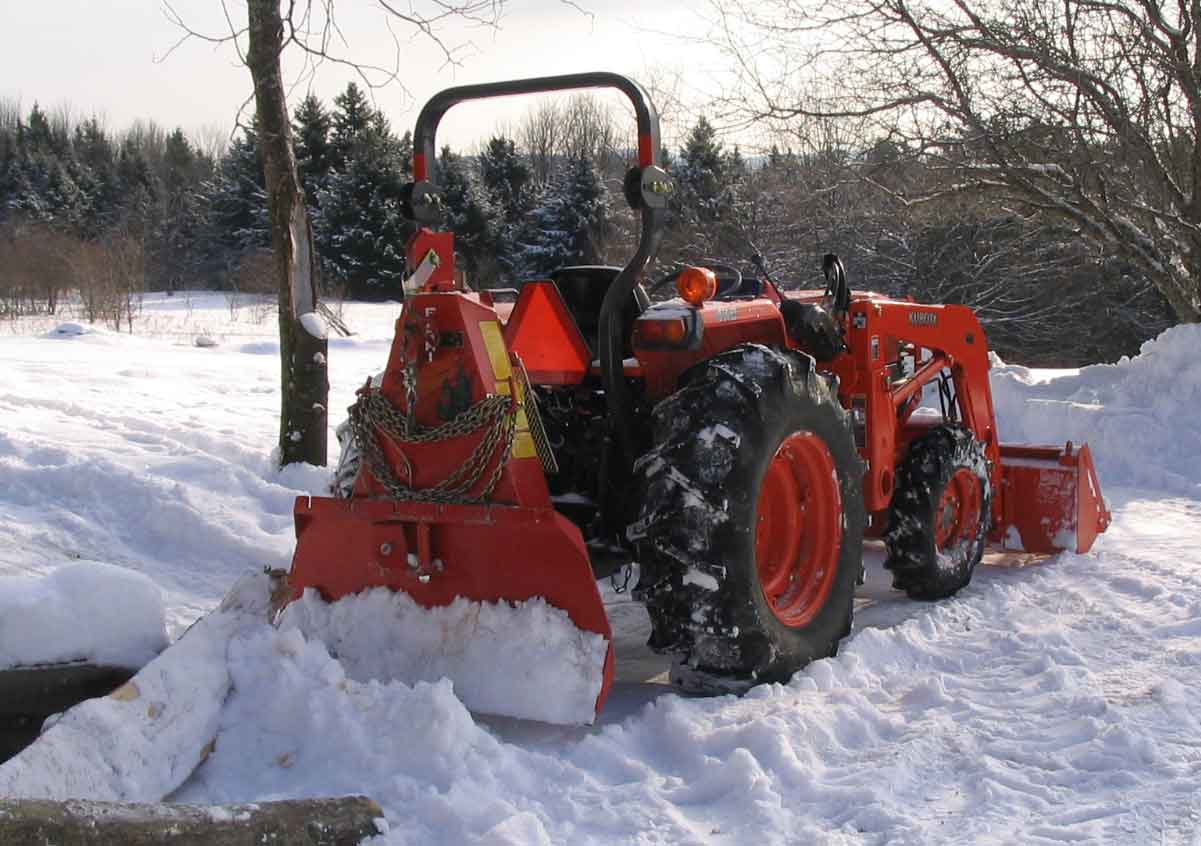

You can drag a lot of logs and pick the front end of each log up to keep them out of the dirt if you use a drawbar across the 3pth. put a clevis with a grab hook in the middle hole and use a 5/16 inch chain with a slip hook on one end. Hitch the slip hook around the log, hook the chain to the drawbar hook, lift the 3pth and drawbar and away you go. Just don't hook anything to the top link, that's the 3rd point or top of the triangle of the 3pth. If you do hook to that your widow will be making your next post in the forum.
Another option to expand on something you mentioned in your post is to use a winch; if you're doing a lot of skidding it'll pay to get a Farmi type logging winch which will make the whole thing a lot easier and safer. I'll try to attach a pic I took today of my L4400 with a 351 Farmi winch pulling out firewood.
simonmeridew
