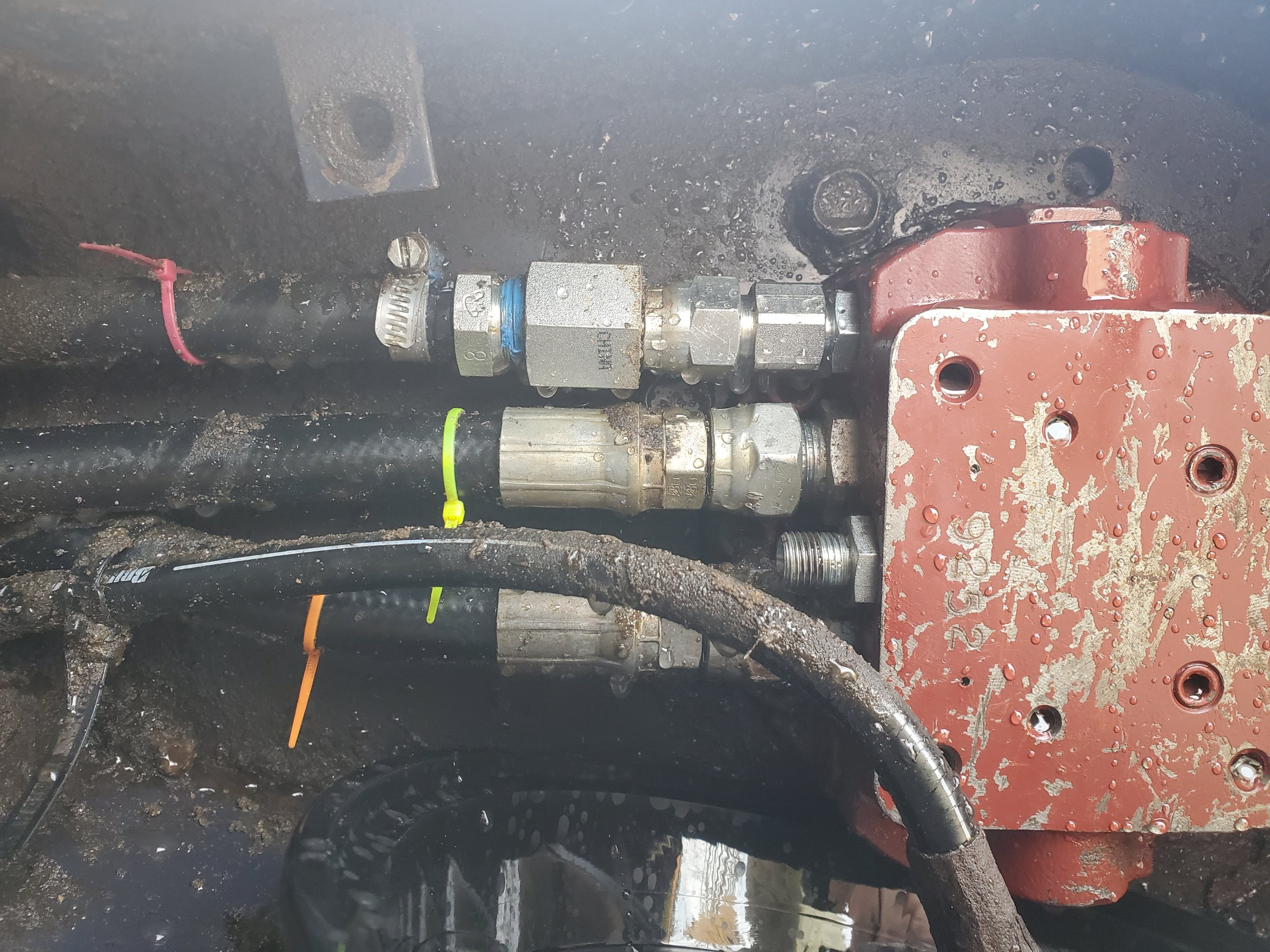

Any tips as on how to get these lines off? So many things I can put a wrench on...so little space to put/move a wrench..
I feel like some of the things that should move, don't ..and then other be things seem to to be freespinning unexpectedly
I was able to get the small one with the elbow and then the big top line off but when trying to do the one in the middle I just can't seem to get things moving in the right direction.
Should I expect that something in here is reversed threaded?
   / Help disconnecting final drive from kx121-3 #2
Every line on my Ihi 35j I’ve had to heat up the fittings. I use a propane torch. Have to be careful with the rubber parts of line. None of mine are reversed threads. Put a piece of scrap metal where you done want flames to get. Heat up and then spray penetrating oil on it takes two wrenches to break loose
