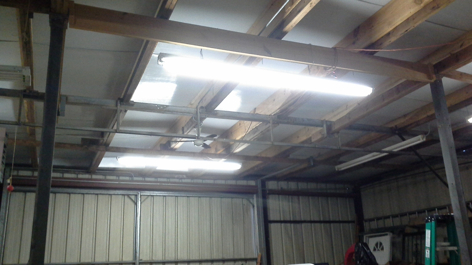

I've got a 40x60 shop w/ 12' ceilings. It's presently got 2 support posts near the center. The posts are 4" x 3/8" angle iron 13.5' apart.
Because of the possibility with this changing climate dumping 10" of snow on us I'm thinking of upgrading and making a support for a hoist at the same time.

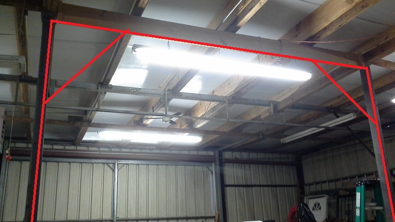

I'd like to put up 2 posts adjacent to the 2 present posts with a beam running between them that I can hang a 2 ton hoist off. See red.
I'd like to be able to lift about 2K off the back of my trailer or truck, so I don't need a Shield Arc 10K gantry. I'd probably "tie" them into the present posts.
So to TBN - either what's a good site to figure out what I need for steel (pipe, column, beams?) or suggestions for what I need?

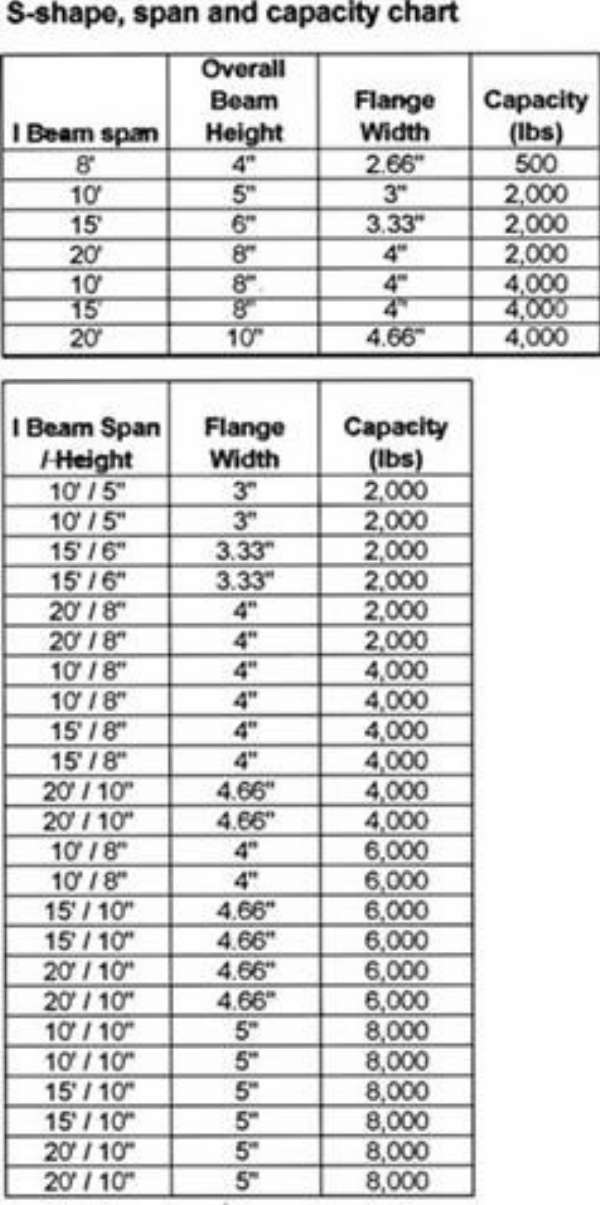

If you know your loads, this chart may help. ;)

I would just add another one or two beams to the one already there, looks like you have the room.
Then, wrap a tin sheathing around where the chain will be for your hoist.
I would also add the re-enforcements to the side's like you showed in your drawing.

I was planning on 2 uprights, a crossbeam, and braces as indicated in red.

Like I indicated I planned on putting braces to support the crossbeam so it didn't span as much.

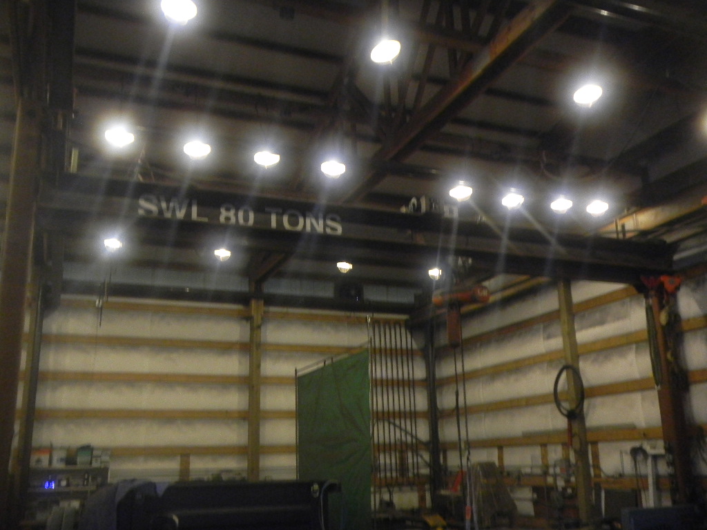

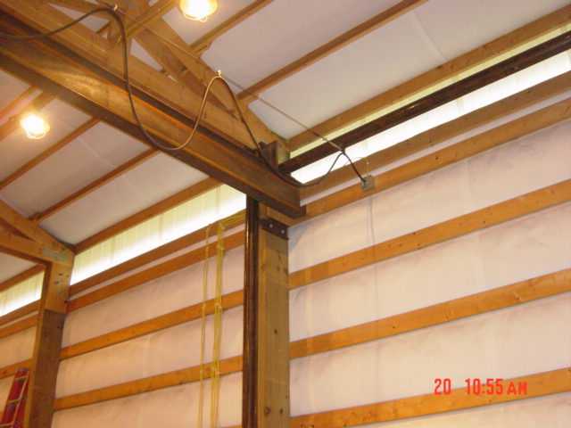

When I built my bridge crane. I designed it, sent Auto-Cad drawings to the head of the engineering department of the company we worked for, so he could tell me what size iron to use. I told him I planned on use 4-inch schedule 80 pipe for the posts. He said he wouldn't even waste his time figuring the loads for that pipe, it was way over kill. I ended up using the pipe in the four corners, but used 8" x 8" x 1/2" wall square tubing for the two center posts. Hey when you get the iron for free, you use it.:D
