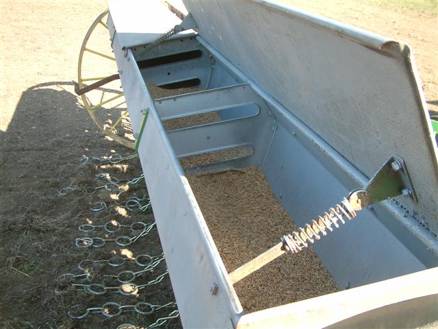

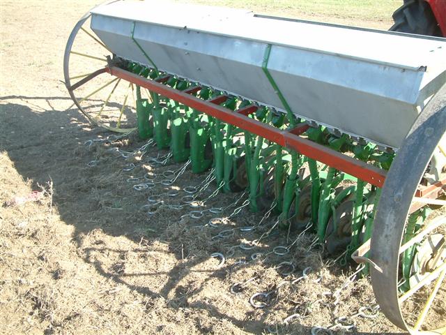

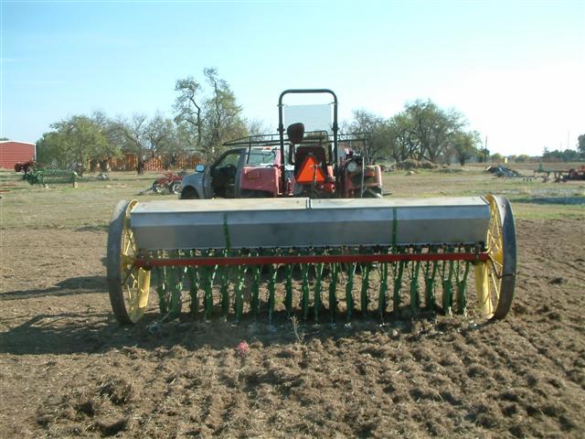

A few years ago a restored an old Minneapolis Moline P3-6 grain drill (10 ft wide, 20 feed tubes, single disc openers). Bought two drills from a neighbor for $275 and used parts from both to make one usable drill. Planted 6 acres of Kanota oats with it two seasons ago. This project was a complete restoration.
