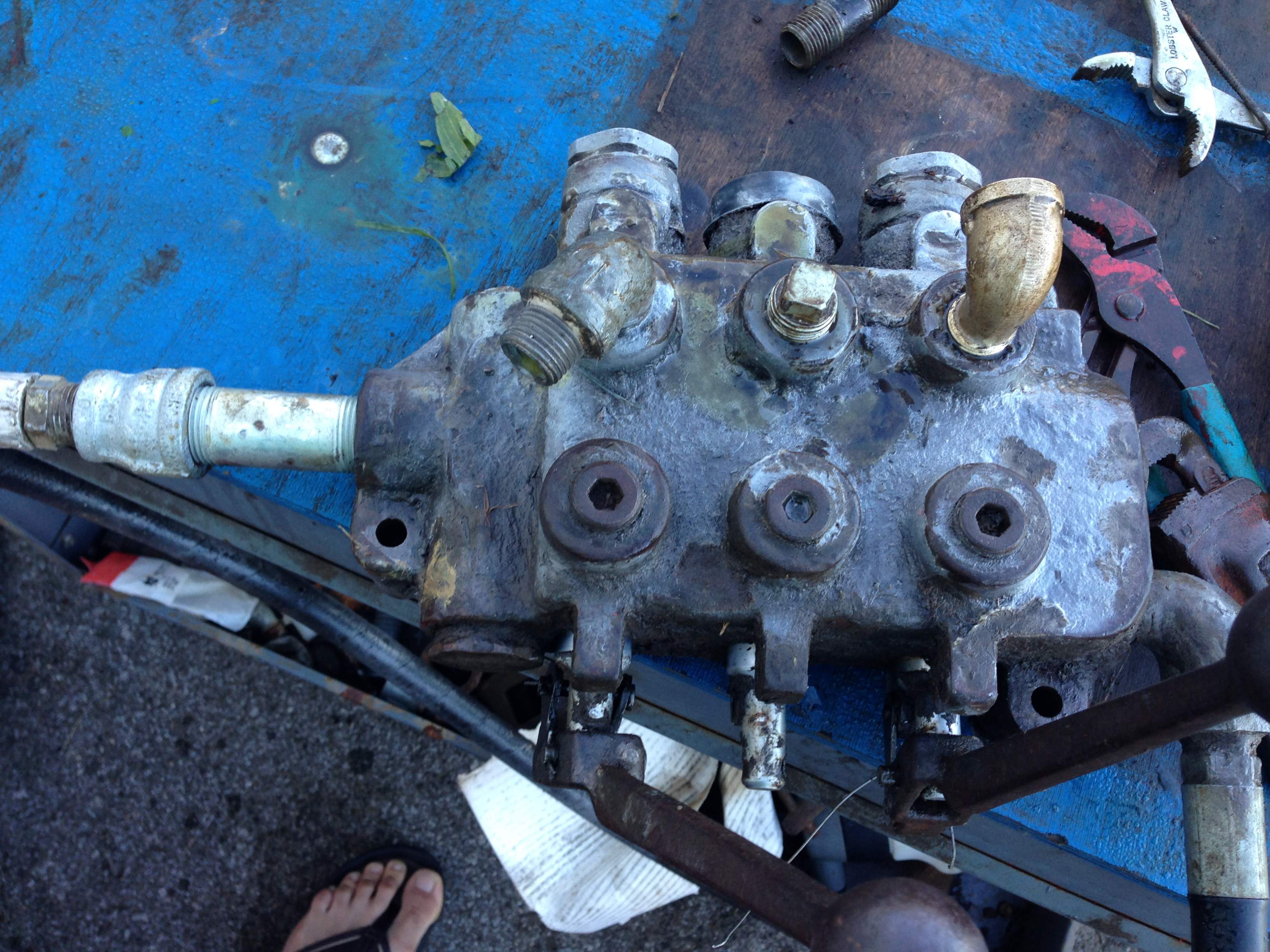

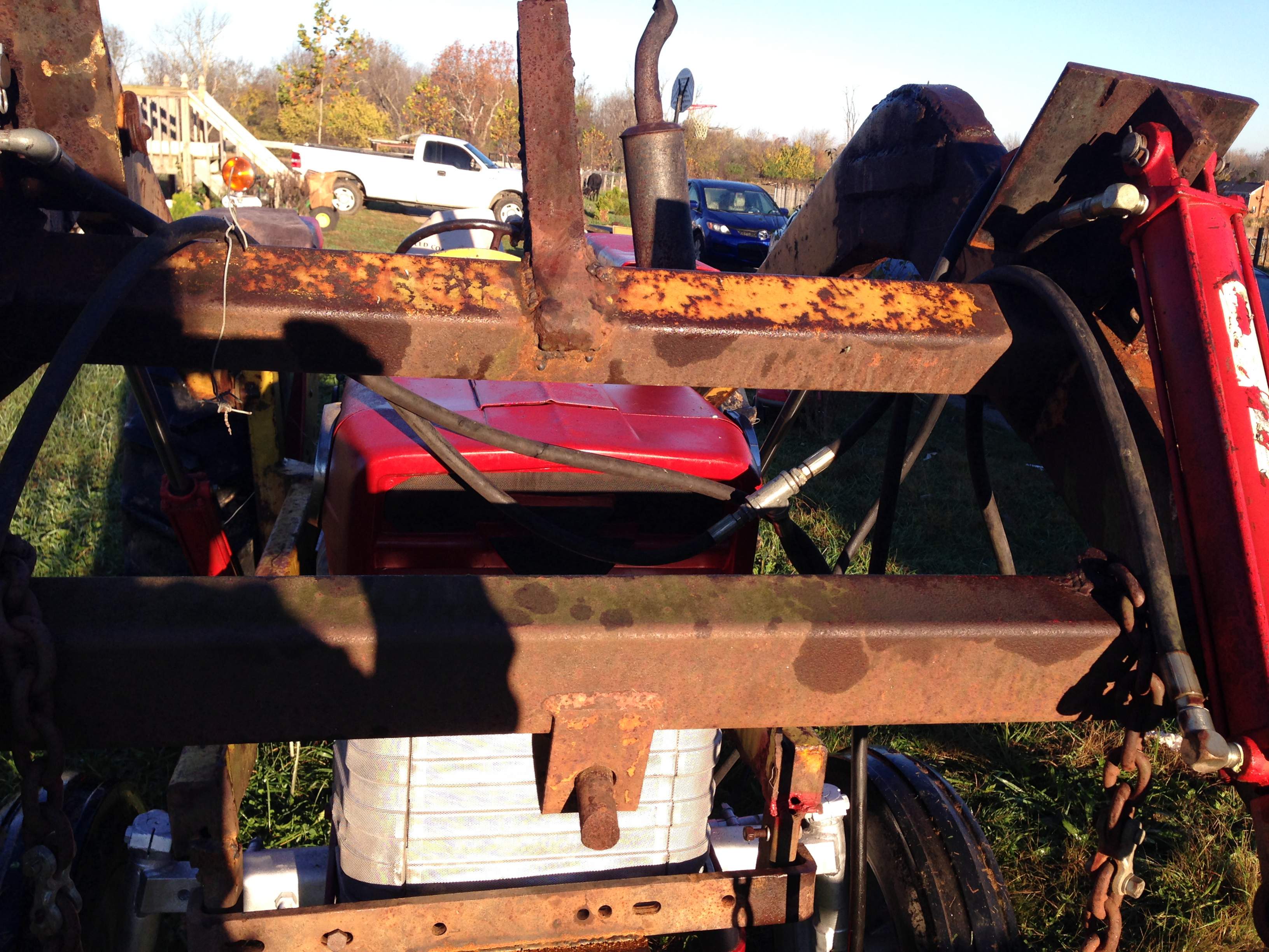

I have a Massey 135 that I am trying to attach a Freeman 2000 Loader. I have it mounted but having hard time hooking up the hydraulic lines. I have a hydraulic valve selector that I connected to tractor so I can run hydraulics off of that but I don't how to connect everything else. The front cylinders have 2 hoses on each side to tilt bucket (then connect at a T and go back to tractor), the back cylinders have one hydraulic one, so I have a total of three hydraulic hoses I need to connect but not sure how. If anyone could look at the photos and give me any suggestions I would greatly appreciate it.

T the 2 boom cylinders then you'll have 2 H lines and hook them to the valve body and see what happens.
   / Help Hooking up Loader Hydraulic Lines #3
i cant tell but it looks like the boom cyl. have vent plugs in the top ports ( to make them single acting ) if thats so . it will work , you just wont have down pressure( gravity down only ) so each valve on you 3 spool valve has 2 ports in line with the handle , you single boom cyl. line would hook to 1 port for 1 handle and the other port stays plugged.
The 2 lines from the bucket cyl.will go to the next valve( 1 line per port ) the 3rd valve remains unused ( I would take the handle off the unused valve to prevent accidentally hitting it )
Hope this helps
Scott

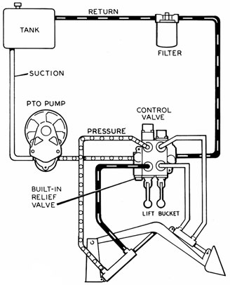

Here a good picture on how things should run.

I will try what Scott suggested when I get the chance and will let you all know how it goes. At the parts store I was told these fittings were all the proper PSI rating for what I was hooking up. Thank you all.
#9
No luck. The bucket works great but the cylinders aren't working correctly. The left cylinder will open and close a little but other cylinder won't do anything. Don't understand why as they are connected at T and lines seem identical. Any suggestions?
