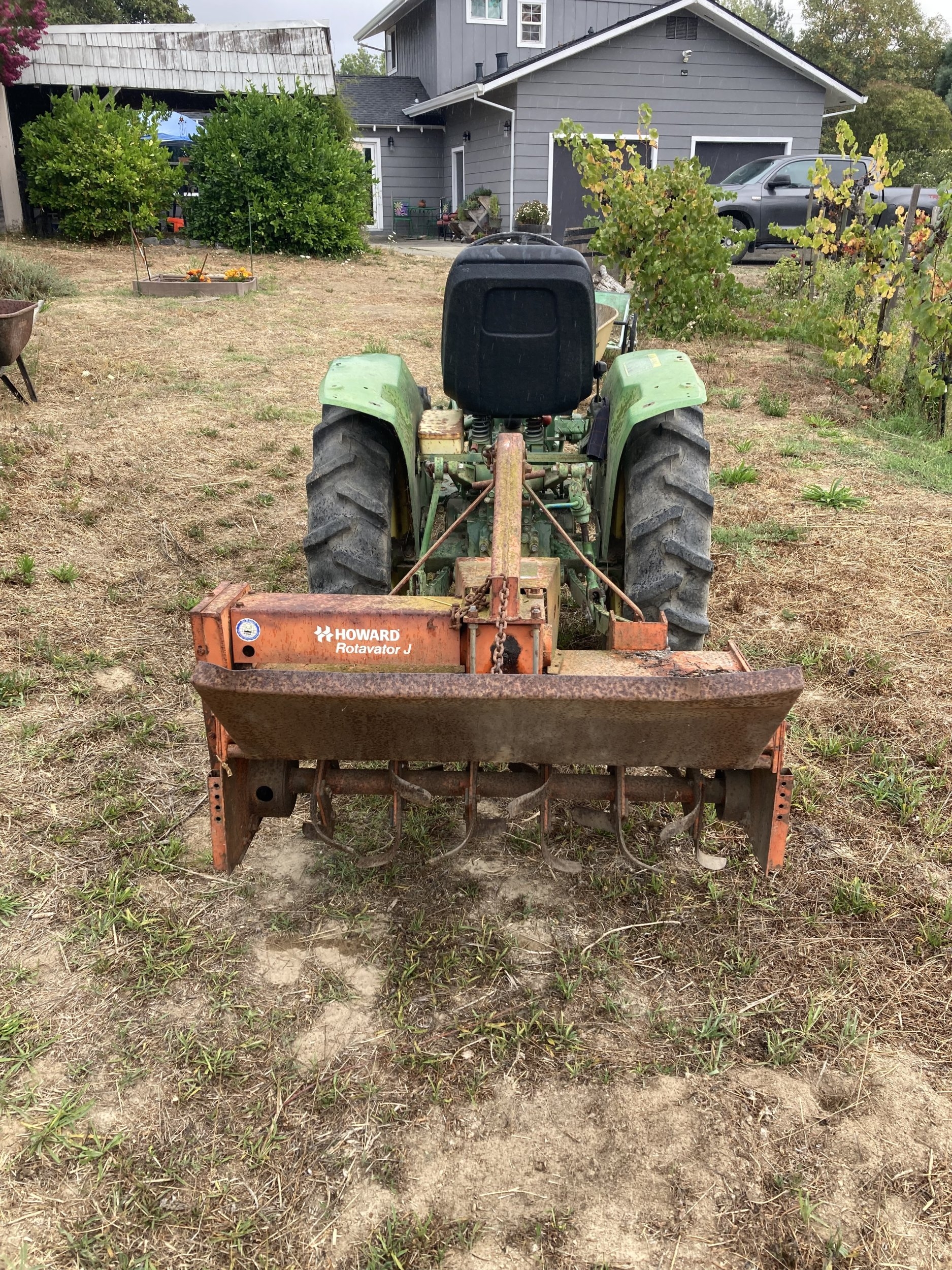

I am also in possession of a Howard Rotovator from a neighbors pasture. I want to run it but am having a heck of a time finding the manual with oil or grease requirements and where to fill it. It is a J model, looks to be 48" or possibly 50". But I did find some info for lubricating this, using the lower fitting as the "full" mark. But not sure if that is all there is to lube. Since its been sitting for 20 plus years, I think it wise to grease it up. If anyone has a link to Howard maintenance site, would appreciate it.
