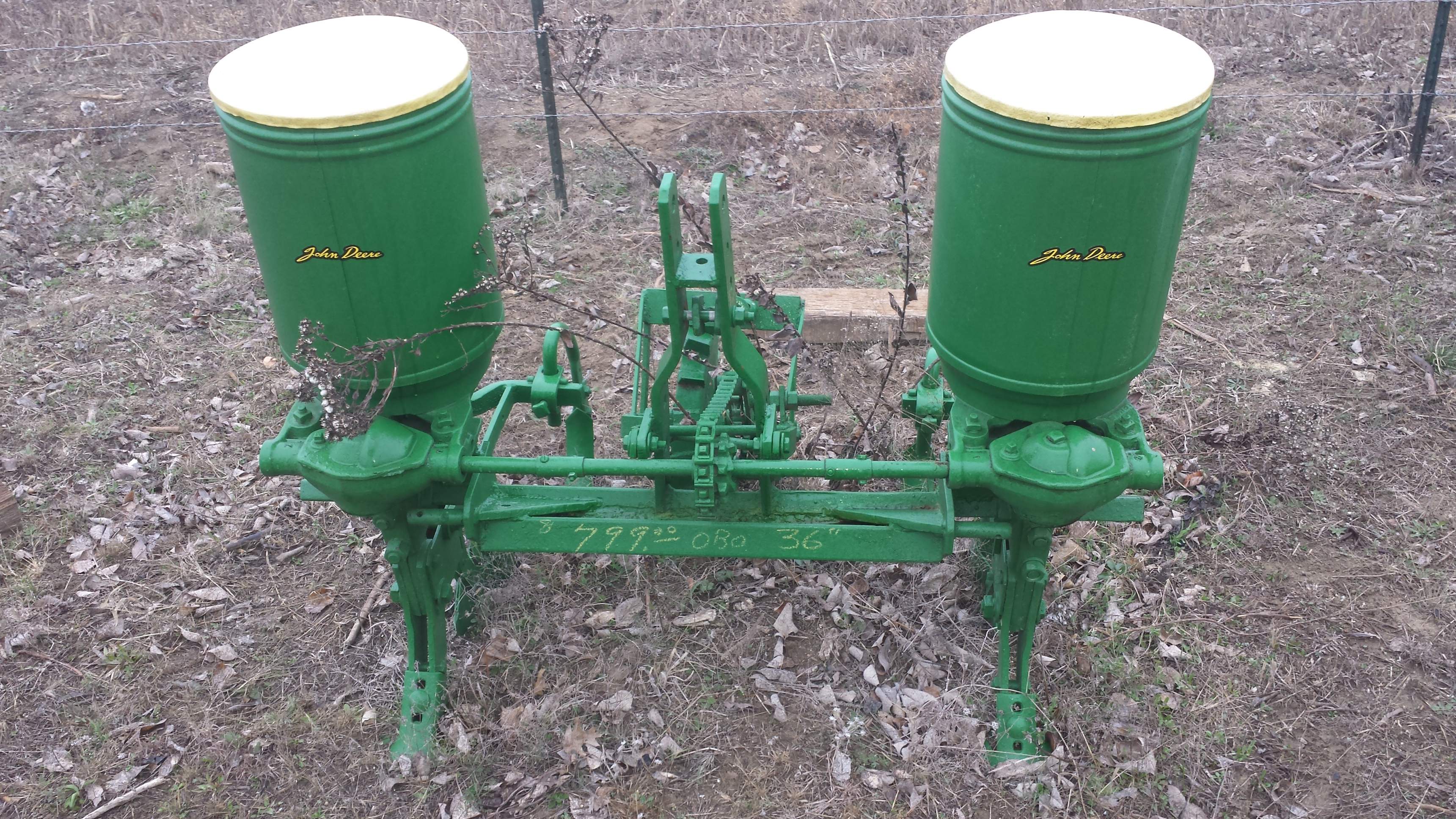

Hi Folks,
I recently picked up this planter for some food plot work and am having some trouble identifying it. It is in good shape and looks to have been reconditioned. While the paint says John Deere, I've gone through nearly every John Deere manual I can find and still have yet to find anything close. Perhaps it was just what was in the paint gun at the time?
Specifically, it has no press wheels which it seems most John Deere planters, even antique ones come with. The planters are set up on 36" centers on the bar and I'm guessing with the correct tractor wheel spacing the next pass, the tractor tire performs the "pressing" of the soil on around the seed.
It came with several sets of John Deere "B" planter plates which I'm assuming fit it, but have yet to verify they do.
I would like to identify it if possible and find a manual that will explain the setup for various seed.
Any help would be greatly appreciated. Thanks.

Hmmm, maybe it is designed without press wheels and the sweeps on the cultivator shanks are intended to just toss dirt over the seed to cover it. Beats me.
Was this planter bought in Paris, Texas? I saw one like this on CL recently.

It may be a sidedresser , fertilizer applicator .

Looks like someone just sprayed it JD green and stuck some stickers on, either to match their tractor or to spiff it up for sale. Did you pay $799?
   / Help ID'ing a Planter
naw, it was part of a package deal $1800 for this, 5 ft Bushhog mower and 6 ft heavy duty disk....slice it even and call it $600...
Bought near Whitewright, TX....about 40 miles from Paris, TX
