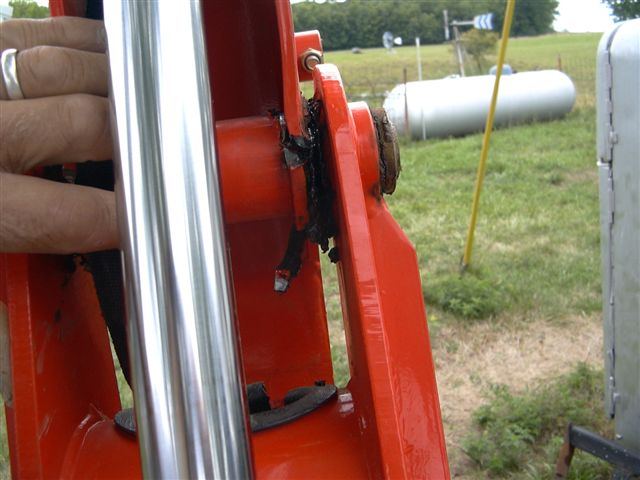

/forums/images/graemlins/frown.gif /forums/images/graemlins/frown.gif Dad just called me this evening and told me that the backhoe had broken near the pivot point of the lower arm opposite of the bucket. he said it is the 1/4 in. thick metal. every thing else is 3/8 in or more. IT SUCKS. I've had it for 2 months and it had to do this. /forums/images/graemlins/frown.gif guess it will be my first warrenty issue.
has anybody heard of this happening? I will get a hold of my dealer in the morning. Mark

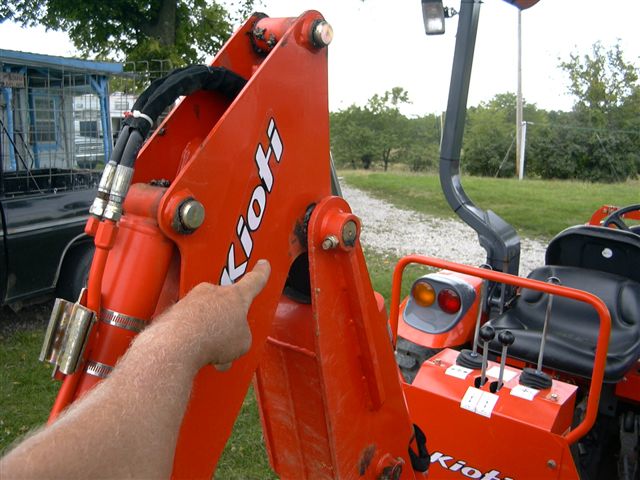

here is a other pic that dad emailed me.

another pic. you can't see the crack but it is suppose to be somewere in the vicinity of pointing finger. Kioti John do you have any ideas?? /forums/images/graemlins/frown.gif

bummer...... /forums/images/graemlins/frown.gif we have never seen this happen before, but we don't have many of the KB2375 hoes out there.... mostly rhino stuff. Hopefully they get you patched back up and back to work. I know you sure stay busy with that BH ! /forums/images/graemlins/grin.gif
What was he using it for when it broke?

Can't tell from the photos. Is the spacer (that the pin goes through) between the 2 cracked pieces welded to the plates that broke out.
If its not it sure looks to me like it should be to make it stronger/more support.

yes vince the weld and the plate Broke at the spacer. only 1/4 stuff. on the backside it needs to be heavier and thicker. only about 1/2 in if that on the back of the spacer. needs of be more. I would weld some extra stuff on it but still under warrenty. will have to see after warrenty.

almost forgot Jon dad was moving loose dirt that was compacted a bit so he could get better access to move it from the pile. basicly not a whole lot. mark

I haven't heard of this particular break happening before. I do know that on some of the earlier 2375s there was a problem with breakage on the stabilizers down near the ground pads, but after Bigtractor weld-repaired one and sent Kioti pictures, I see that they adopted his structurally-strengthening modification on the newer hoses. I have to suspect that there was a flaw in the metal at that point as I have done far more stressful operations with mine than your Dad was doing when this happened to your hoe. I'm happy for you that it's under warranty, and I'm sure they'll get it fixed up for you. They should give you another hoe in my opinion though, as I think there's probably too much flaw there simply to repair it.

thanks for the reply john. I feel like they should give me a new hoe too if not the arm.
I can arlready think of a better way to reinforce it but don't want to hurt the warrenty.
taking 1/2 plate and cutting it to fit around the shaft and then welding the plate to the 1/4 plate and the shaft would go a long way to making it a lot stronger.
I hope it doesn't take to long to get it fixed as I needed it yesterday. mark
