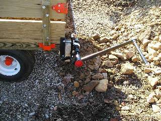

I extended the frame 6" on mine by drilling another hole in the coupling pole, because I wanted the bed 9' long and I didn't want much overhang because I modified and installed a loadhandler that goes in a full size pickup to make it easy to unload rock, dirt and wood, works like a charm, can unload rock with one hand.
