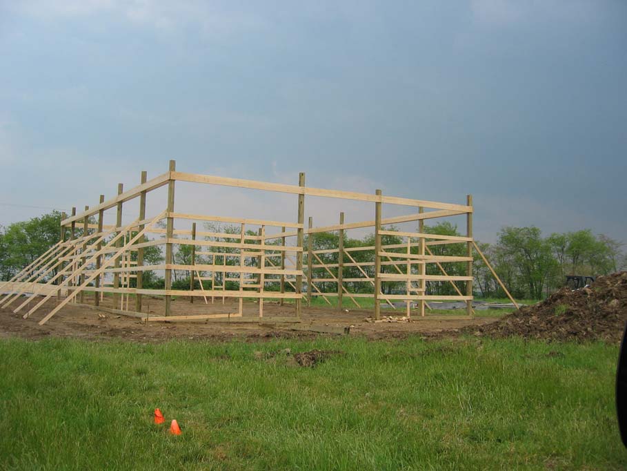

I'm building an equipment shed. It will be 24' wide x 16' deep. It will be three sided, some may call it a loafing shed or run in. I will use pole construction and need help with setting my poles square. I've built small pole structures in the past, and would just measure diagonally from corner to corner. With 12 poles I'm confused as to how to keep everything square.

   / Help me build a square pole barn. #7
This pic may help...
