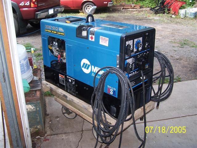

A couple years ago I needed a new welder to replace my 30 plus year old Sears buzz box and I needed a bigger generator to replace my 5K (6250 surge) unit. I sold my 5K to my neighbor and gave the buzz box away. Then shopped around and bought a factory reconditioned Miller Bobcat 225NT welder / generator rated at 10K with 19 hours on it and a 2 year warranty. List price at the time was about $2900. but got the whole package for under $2400 including 80' of welding cable with ground clamp and electrode holder. It does AC/DC welding and will run my whole house and garage when the power is out. I bought it from a local welding supply company. Northern Tool also has a Hobart 10K generator but only does DC welding for about $2800 new. Hobart and Miller are about the best you can get in my opinion. All you'd need is a helmet, gloves, leathers, and rod and of course a pigtail with the proper plug to run your house power..

At work we have a 10kw hobart / stick welder.
Nice unit.. 'tool-ess' oil change and all. Runs great .. nearry a problem with it. it burns rods better that a lincols 225/180 ac/dc unit by a WIDE margin.. and I consider the lincoln tombstone as a 'gold standard' when compairing arc welders.

you can get a 10,000 watt generator/welder,hobart,off of northern for under 3,000,its stick,,dc,,,you don't need ac for stick[you don't want ac for stick if you got dc] ,,its big enough you would be able to plug your mig into it.
As far as how big a michine you need to weld 3/8th inch,,you don't need a big one,,as far as stick goes,100 amps and 50-60 percent duty cycle would handle that no problem,,course you gotta know how to stick weld and multipass.
Yeah,its just as cheap to get a welder/generator as a generator,when you start talking 5-6,000 watts.
Now,moving this machine won't be easy,,weighs over 400 lbs,,they sell running gear for these,,
Miller makes one,[I got it],called a bluestar 185,,it weighs 315 lbs, battery start,got a wheel kit on it,,puts out 6,000 watts peak and 5,500 continous watts,dc output on the welding,about 75 percent duty cycle at 120 amps,,all you need to burn a 1/8 rod all day,,it will power my water pump,tv,few lights and furnace all at same time,[what else does a man really need on a cold day].Good welder,smooth,,seems like it was under 2500 with running gear,,,its light enough you can move it by yourself with the running gear on it.
