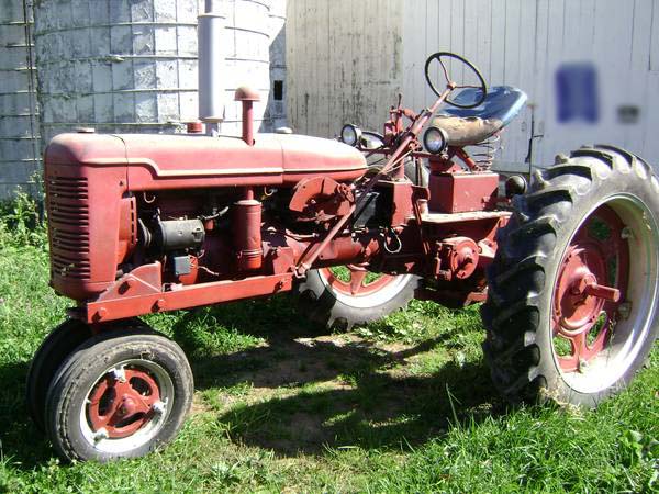

I was hoping I could get some help identifying this Farmall tractor. I'd also like to know if it has much value. It is sitting on a piece of property we just bought (though we haven't closed on yet). All I know about it is that it's been sitting in a barn, and supposedly it starts. Beyond that I know nothing about it. I have a BX25, and that is the extent of my tractor familiarity. Can an old machine like this be at all useful to me on a 7 acres of hobby farm pasture, assuming it runs, or has the potential to run?

Looks like a "C"model Farmall. 1948..1951..about 18 H/P
Value..??

Definitely a Farmall C. You can tell by the straight clutch pedal. Super C's have a bit of a bend in them at the trans. platform, where they make contact.
Depending on what you're going to do on your small farm, I bet you'll be surprised how much you would use it. I have 2 Supers w/Fast Hitch, and are my "go to" tractors for probabaly 75% or more of stuff done around here. A bit more handy than a C with just a straight drawbar. But I rake & ted hay, one is hooked to the manure spreader all of the time, unless needed for something else. I have a small bolt on the drawbar seed spreader I use to reseed pasture, or they hayfield, or Rye on the garden. It'd be handy to pull a wagon or trailer if you have a loader on your other tractor. If you're going to have a garden, a pull type disk will do a much better job, if you have a big enough garden to turn it. There are a thousand "gin" jobs they can do. The best part, they are easy of fuel..!!
The down side is mounted attachments. Not hard to find, but just takes a good while to get them on.
As far as value, I'd say it'd be worth more keeping it around for odd jobs, than try to sell outright.

Definetly hang on to it. It is a workhorse.
Yep. I was able to swing by today and get the serial number: 60###, which appears to be a 1950 Farmall C. Now I just need clarification from the owner as to whether this actually comes with the property or not. I am assuming so, but if not, and idea what something like this is worth in running condition?

I've seen them go from about $800 to $2000 in running condition.

Try to get any implements he has for it.
