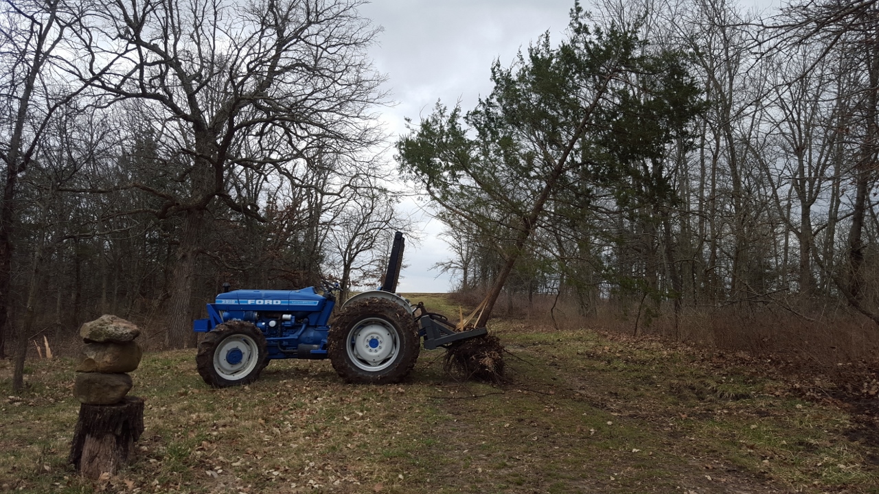

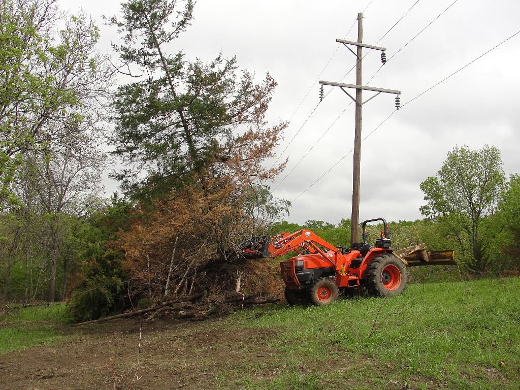

I built a puller. Next to the Grapple, it's most used FEL tool. Wouldn't be without one. A new one locally built here can be bought for $1200.
Here's an example on my old L4400 Kubota.
I built it to also be used on 3pt. Would be very easy to add that modification to the one you pictured.
