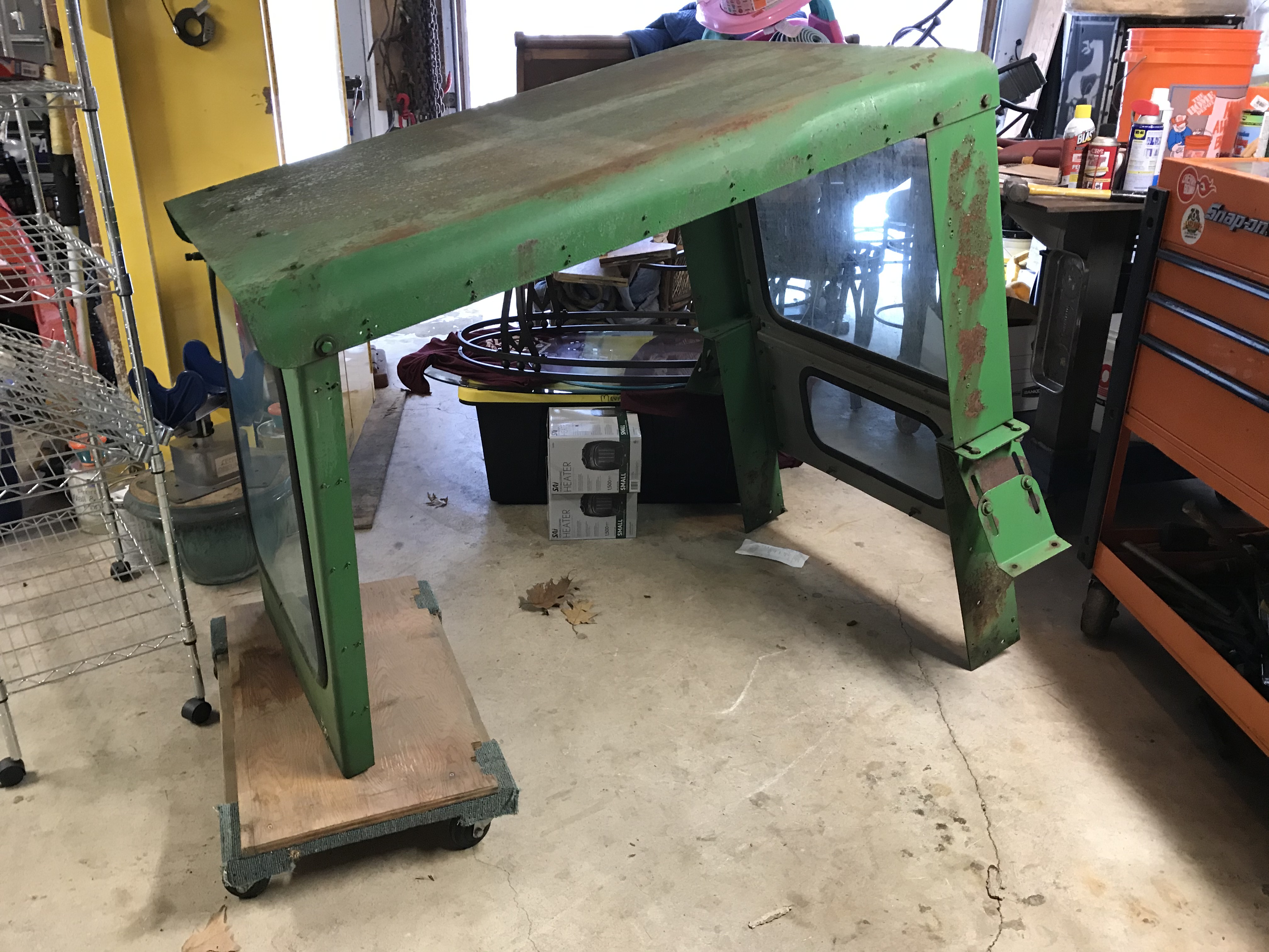

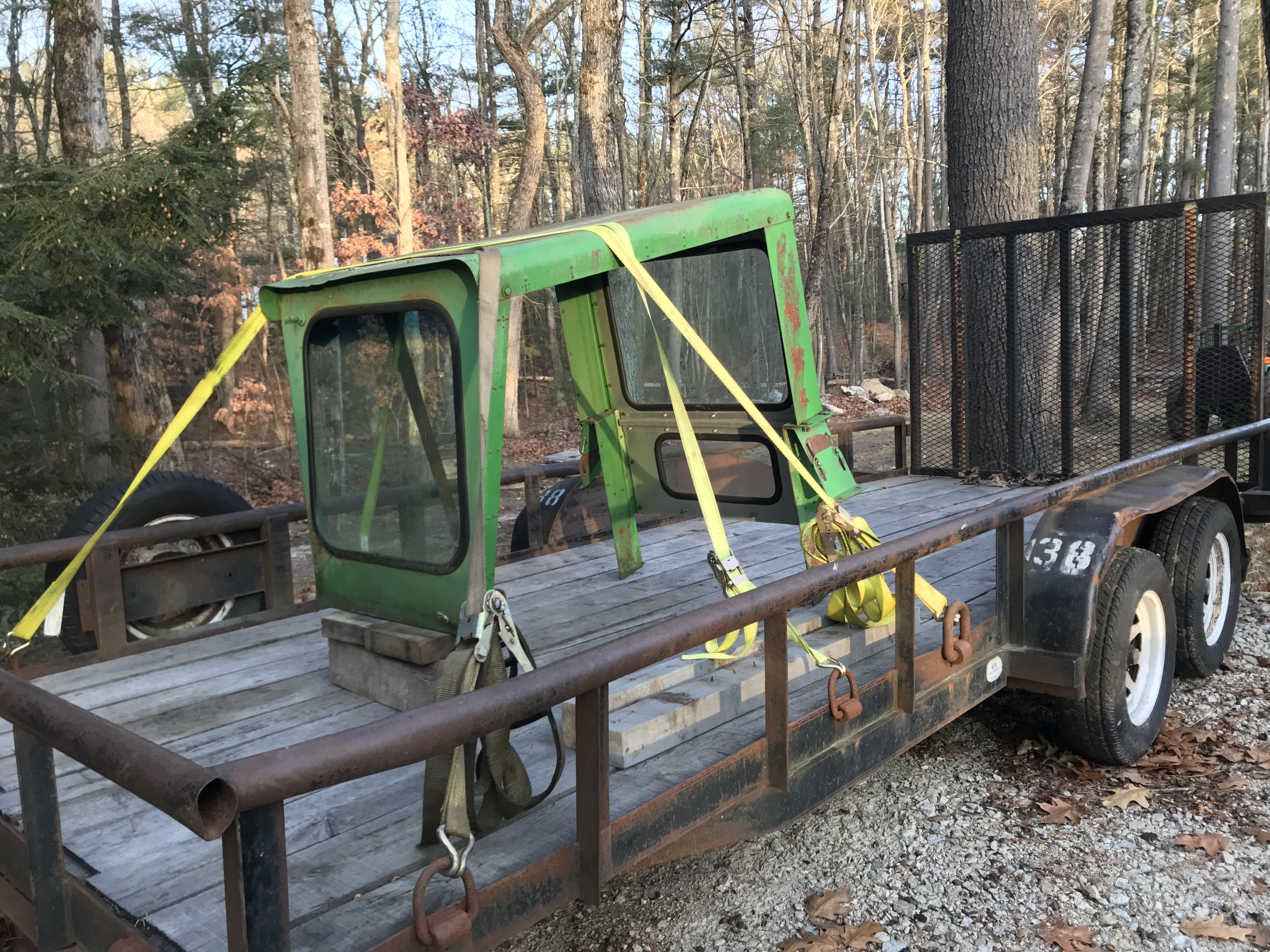

I purchased a cab that was described to have come off a John Deere 1250. I am looking to mount it onto a John Deere 970. I can already tell I will have to fabricate front posts from to connect from floor boards or loader mount to bottom windshield. The width in read puts it about over the fenders. I am hesitant on drilling into the fenders to mount the rear of cab but I am unaware of what correct mounting hardware I should be using. The rear of cab supports measures 32", while between my 970 fenders measures 28" inside to inside; therefore I believe I have to mount it over the fenders. Any help would be appreciated. Thank you. Cab.jpgcab1.jpeg

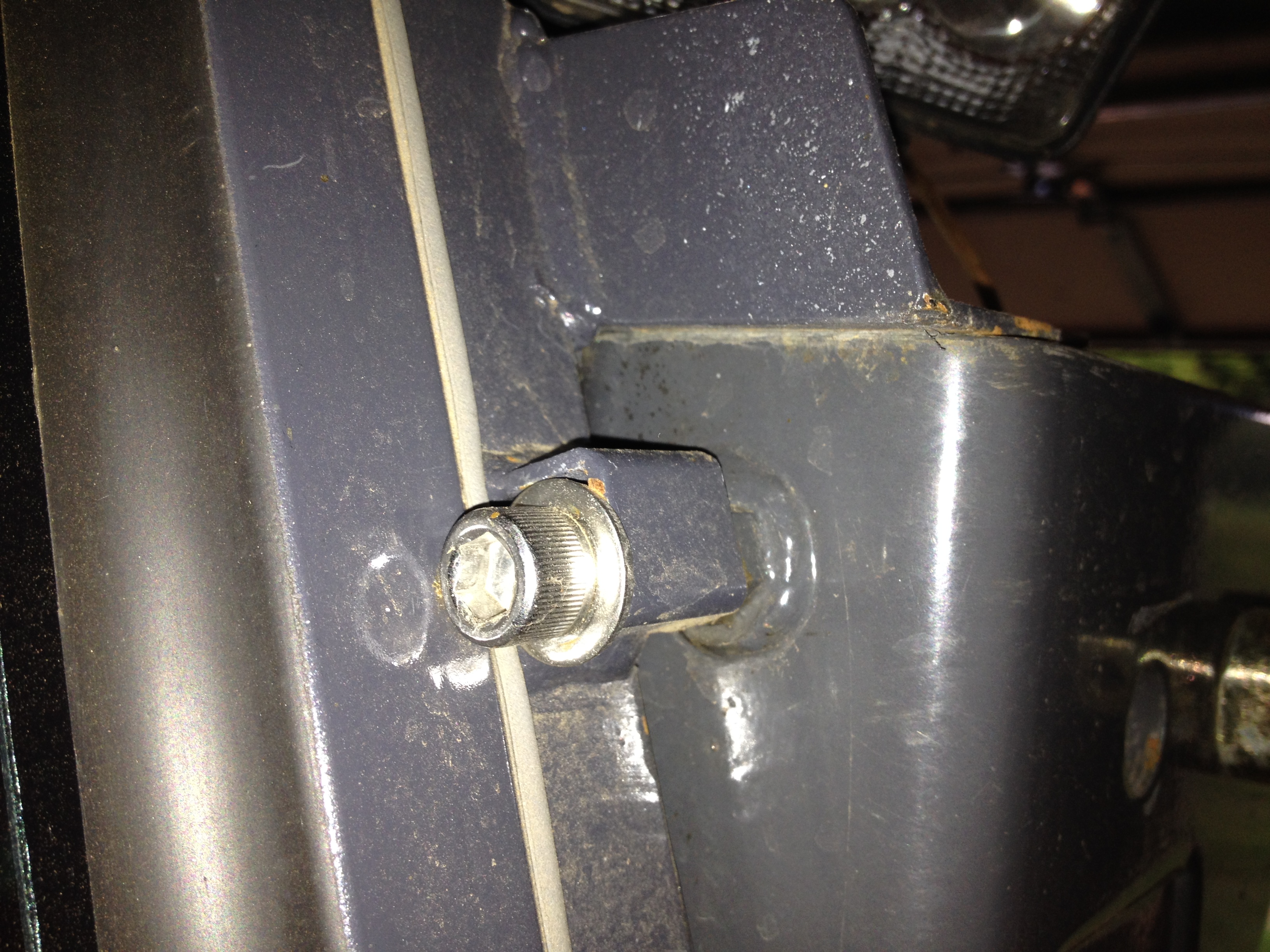

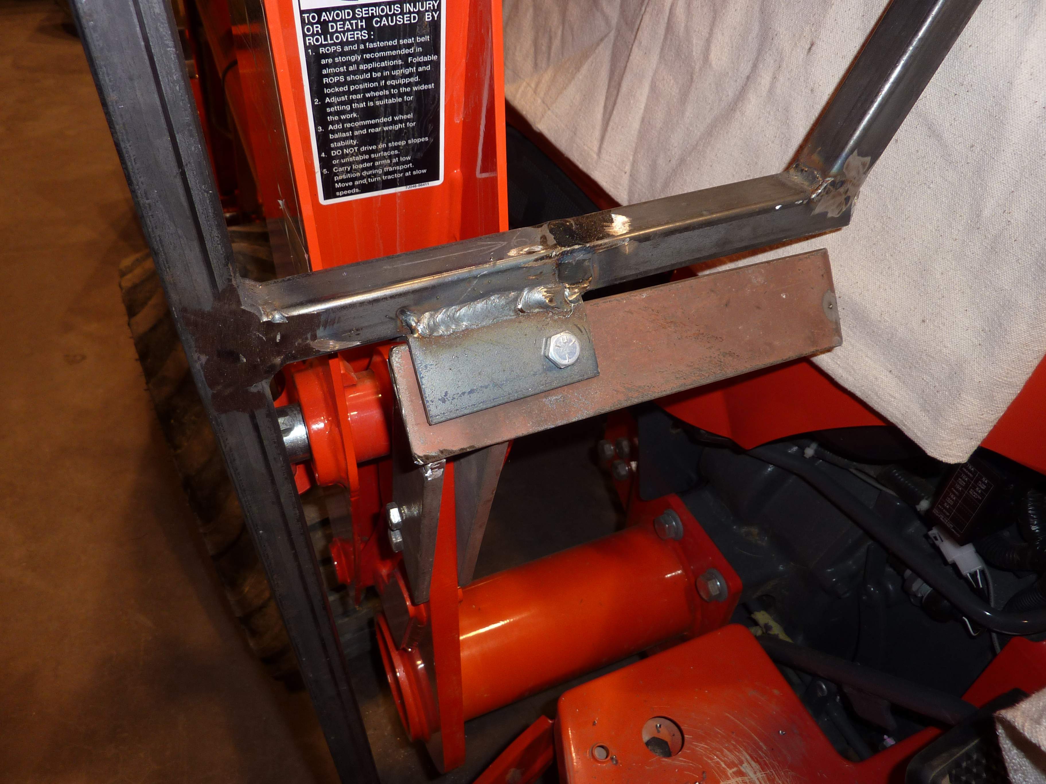

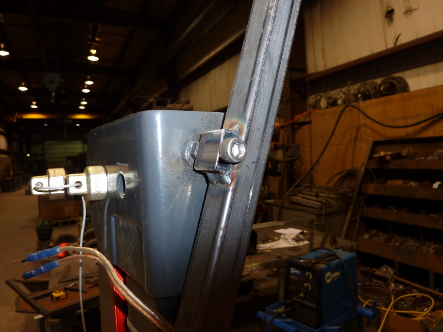

Don't call the ROPS Cops. The L3200 doesn't fit in the shed with the ROPS up. It's been folded since new. The cab was built so it clears the overhead door by a couple inches. On the rear frame of the cab, I welded a pair of clip angles that sit on top of the folded ROPS. These clips support the rear of the cab for weight. Then I welded short pieces of tube steel to the sides of the cab frame and bolted through them into the ROPS nuts. If you have clearance for the ROPS, there are a number of ways you could do it. One is as you mentioned. If I did that I'd look for a way to add "legs" of some sort that would bear on something solid so the clamps weren't holding the weight.
The third picture is a mirror image of the FEL suppport on the right side. Both front supports are short pieces of angle that sit on the supports and are bolted to them. The cab was built in pieces so it can be removed, but I only took it off the first Summer. Lifting the doors off more or less makes the cab a canopy. If you're bored some evening, here's my build:
