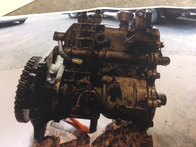

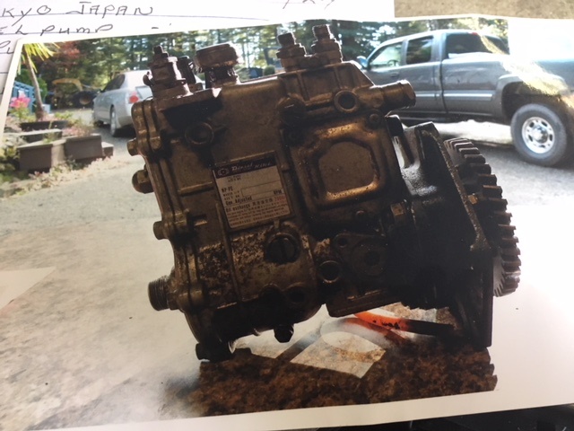

Hi all, can you help me find a part please? We have looked everywhere. I need a fuel pump for a Iseki tractor, model TS1610. All info I have on it below.
Inj Pump 4302-610,
Fuel Pump Diesel Kiki, Assy 3PF050646,
Maker I/P Assy 5-15610-657-1.
Gov Adjusted 450-1150 RPM
Hoping some of you might at least have contact info for parts houses who would have it or be able to track it down. I've tried contacting Iseki directly but haven't heard back yet.
Thank you!
Ed
Attempting pics attach below...

ANY fuel shop will/can rebuild it.. just call around "local"..
Tell'm you have a Kiki 2 cyl. PES pump of an Iseki tractor.. should run you around 600.00..
It would be a MIRACLE if you found an exchange unit.. & "IF" you did, it'll be well over 1000.00
   / Help! Need fuel pump for Iseki TS1610, details within... #3
Whats wrong w/ yours?? Normally folks don't put oil in them & the bearings "go South"..
OR the control rack sticks & wont pump fuel..
OH>> & your looking for an >injection pump.. NOT a fuel pump.

This is for neighbor. if that info spells injection pump, I believe you, you guys know a lot more than we do. Not sure whatç—´ wrong with it. Does the advice about taking it somewhere local to be rebuilt stand with it being an injection pump?
   / Help! Need fuel pump for Iseki TS1610, details within... #5
yes.. 99% of injection pumps are rebuilt when repairs are needed..
Local if you have a place..
IF you take to a "tractor repair shop or the dealer" they're just gonna send it off to be rebuilt & charge you a hefty mark-up..
Just google> injection pump shops near Arcata".. simple as that..
Good luck..

I just found out that it had already been sent out to a place to rebuild and they said they couldn't do it, not sure why. If anyone happens to stumble across one please reply and let me know. Thanks for your help.
