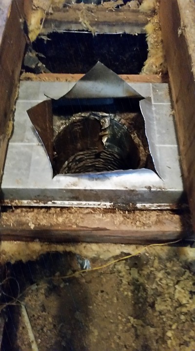

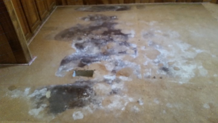

This is something new to me. I have a client who owns an older double wide mobile home with some soft spots in her floor. Normally this is a pretty simple repair, I remove the carpet, cut out the bad area of particle board and install new particle board. When I pulled up the carpet, I saw this!!!

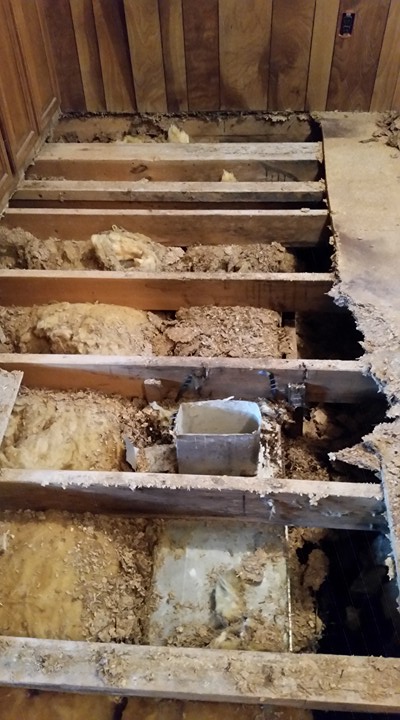

I removed some of the wood and realized that the mold and rot was fallowing the path of the HVAC duct under the floor
Then I felt the top of the duct and found it to be wet. Some spots where so wet that the insulation around the duct would drip water.
So my first thought was there is a leak somewhere. On the other side of the wall is a bathroom. The vanity is right over the duct, so I removed the vanity, cut a hole in the floor and found learned that the duct there is totally dry, and the only pipe that crosses over the duct is the sink drain line, which is also perfectly dry. That was a waste of time, but at least we know it's not the problem.
I removed more of the sub floor and opened up the area so I could get under it and discovered that their is a big air vent line coming from the other side of the mobile home to this side. It's a big flex line, maybe 15 inches. It comes along the ground and then straight up into the bottom of the metal duct that you see in the pictures. The metal is very thin. I cut it with my sheetrock knife. The insulation around the metal duct is also very thin.
If I was to guess, I think that the moisture is thickest, or heaviest at the point where the big duct comes into the metal line, and then goes left to right. I think that the cold air hitting the metal causes condensation on the outside of the metal duct. It is wet on the bottom too, but not as much. I think the moisture on the bottom drops to the dirt below, but it's so dry under there I can't prove that. I think that the moisture on the top has slowly spread out, down along the top of the duct. The joists show wet staining where the duct touches the insulation on top of the duct. Over time, the moisture has led to the particle board growing mold, and then rotting.
Does that makes sense, or am I way off base?
My solution is to super seal up any holes that might be in the fitting that connects the flex supply line to the metal duct. Then I plan to use expanding foam between the 2x6 floor joists and the metal duct. There is about a half inch gap there after I removed the insulation. Then I will cut and fit 3/4 inch Styrofoam boards on top of the metal duct, then R19 insulation of top of the foam with the vapor barrier facing down.
Will this stop the condensation from forming? Will this protect the new 3/4 inch plywood that I'm going to put down instead of the 5/8 particle board that was there?

I think you have the diagnosis correct.
Anything I have read about insulation and moisture is all about isolating cold surfaces from warm moist air, so that the warm side of the insulation is warmer than the dew point temperature. Otherwise, you'll get condensation. No difference whether we're talking about cold AC ducts and warm exterior air in summer (condensation on the outside of duct) or warm heating ducts and cold exterior air in winter (condensation on the inside of duct).
So yeah, insulate it best you can. Also, if you can isolate/separate the ducts from the subfloor and framing as much as possible, that can only help. Anything that puts the duct in contact with the framing or subfloor (even insulation) can potentially conduct cold to the framing and subfloor where moisture can condense. If there is an air break between the duct and the framing and subfloor, you remove that possibility. So I'd say insulate the heck out of the duct, and move it away from framing and subfloor if possible. If space is so tight that you can't move the duct down away from the framing and floor and the duct insulation must contact the floor, then you have no choice about avoiding the conduction aspect.
   / Help needed on HVAC duct and moisture
Thank you. I've been confused on this one and it's real important to me to understand a problem before fixing or covering it up. The duct is tucked right up to the bottom of the floor joists, so I have a 5 1/2 inch space between the top of the duct and the bottom of the sub floor. What amazes me is how much moisture the sub floor absorbed from the vapors of the condensation. I'm thinking that moisture caused mold to grow, which led to the rot and buckling of the particle board. I'm going with 3/4 inch plywood that will be glued and screwed down to make it stronger then before.
