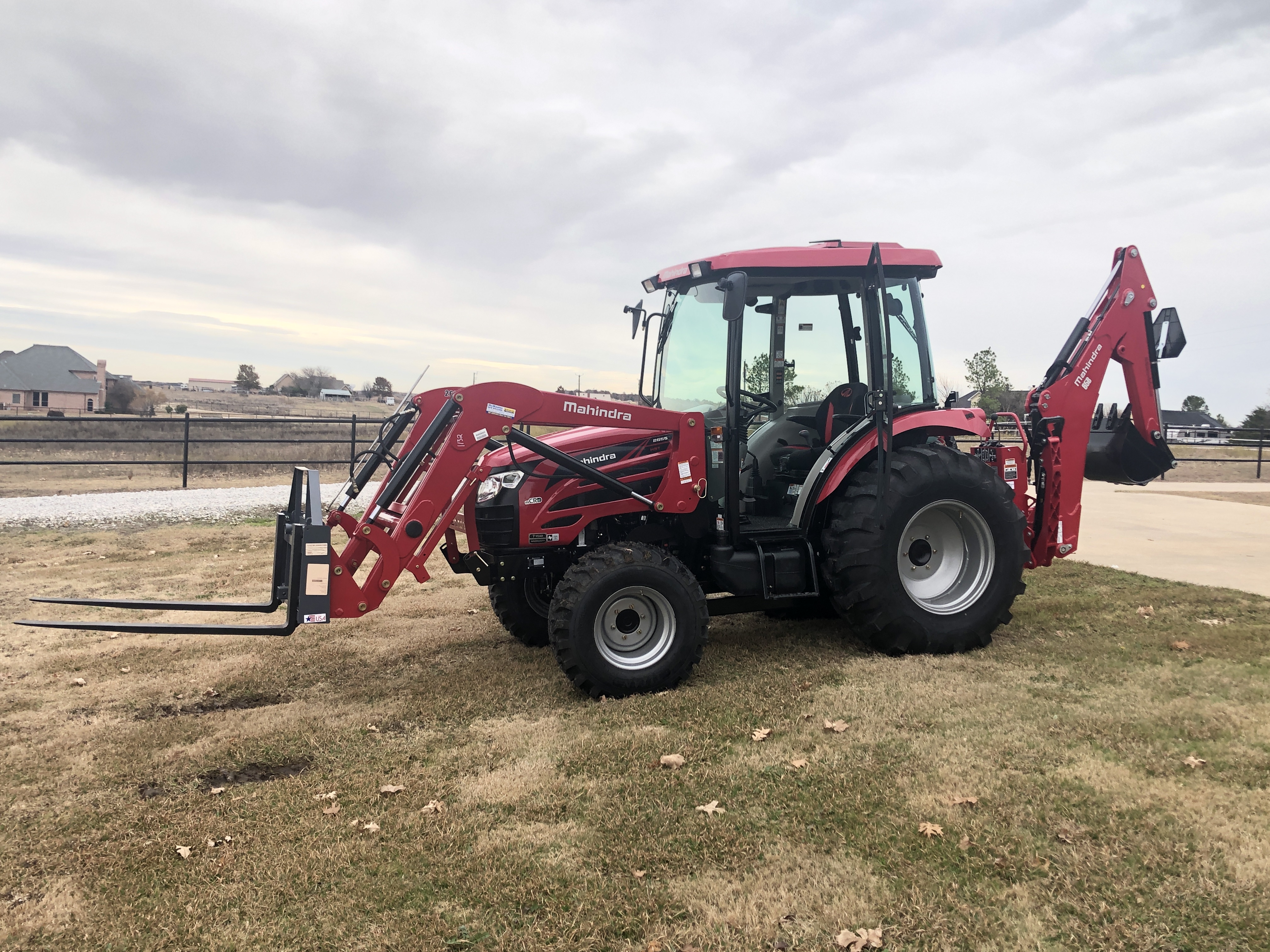

Bought a new 2655 HST Cab w/ Loader and backhoe
Tractor: 4299lbs
Loader: 1270lbs
Backhoe: 1100lbs
Tireballast: 600lbs
Total: 7269lbs

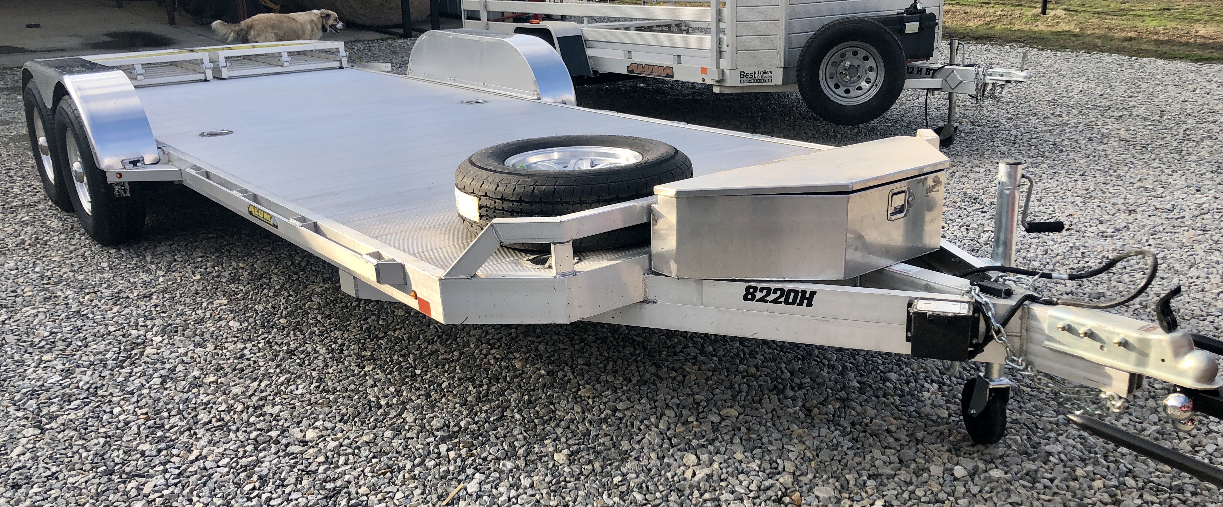

Trailer Weight: 1550lbs (20ft Tandem Axle ALUMA trailer, 9,990lbs rated)
Total tow package weight: 8819

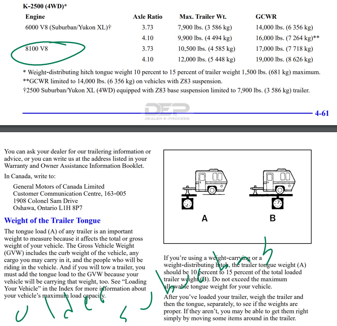

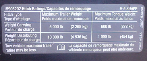

I thought I would just pickup a 2009-2013 Suburban 2500 series. (6.0L) (when not towing, I might sometimes need to haul 8-9 people, hence the suburban instead of a pickup choice) Towing Capacity 9400lbs. However, the HITCH sticker on the Suburban shows 5000lbs/500 or 600lbs tongue weight or 10,000/1,000lbs tongue weight with weight distribution... WHAT?? 500lbs tongue weight?
AND to top it off, you can not replace the receiver because of how it is mounted... (inserted into the frame instead of bolted to it?)
So maybe an older suburban with the 8.1L that is 12000 lb rated. (better engine as well!) However, I can not find any info on the tongue weight ratings... maybe the same... 5000lbs and up you have to have a weight distributing hitch...
SO, if I want a suburban, of any vintage at this time... do I have to have a weight distributing hitch? The only one I can find with enough Drop (level trailer coupler height is only 14") is the Blue Ox SwayPro

I have a 2500 suburban. It’s not my first choice for towing because it’s the least capable vehicle I own but 500 pounds hitch weight is way under selling it. I think it would handle 1500 pounds hitch weight if the hitch is up to it. I haven’t paid a lot of attention to my hitch but know I’ve had at least 1000 pounds hitch weight on it probably more and didn’t feel like it was too much for it. I wouldn’t be eager to hook big loads behind the 8.1 suburban because it doesn’t have an Allison trans. That being said I don’t think towing 9,000 pounds behind a 2500 suburban on rare bases is going to hurt anything. My smaller tractor and trailer is probably around 7500 pounds but I’ve never weighed it and that’s the heaviest load I’ve had behind it. I don’t know how much experience you have with SUVs so I apologize of you already know but the 3rd row seats in all of them are pretty useless. The suburban is better than most but there’s no way the 3rd row is fit for 3 adults especially for any distance. But I don’t care about that. Mine only has the front 2 seats and it’s essentially a 4 door van. The suburbans are far better than a pickup 99 percent of the time. Having your stuff wet and exposed to theft in the back of a truck is way overrated. The Ford excursion is probably a better tow vehicle than the 2500 and definitely has a more room in the cab but they drive worse IMO.
   / HELP NEEDED! Suburban 2500 older or newer, tongue weight limitations w/o distribution #3
The truth is most vehicles until the last few years have the 500-600 rating without the weight distributor rating. They claim the new trucks don't need weight distributors hitches, but I am not sure how they are getting around the problem of unloading the front axle weight when towing heavier tongue weights. The whole purpose of the weight distributor is to transfer the weight back to the front axle, and even out the stress on the hitch mounting bolts.

The reason is most of the older stuff has a class IV hitch and a lot of newer 3/4 tons have a class V which is rated much higher. You can tell because the shank needs to be bigger for the tow ball or you need an adapter.

Not afraid... can’t. The aluminum trailer (Aluma Brand) I just found out says “do not use” with weight distribution hitches. They won’t say why but I imagine it is the stranger point stresses it might on the main beams Behind the coupler.

You must realize tow ratings and capabilities have skyrocketed, the last few years. Gas engine HD pickups are rated to pull much more than the best diesels of twenty years ago. The included receiver on most family vehicles (including most half ton pickups), is rated for the occasional camper or boat to be pulled. Even half tons with max towing packages often come with Class IV, or lower receivers. The manufacturers get by with it by adding, “when properly equipped”, in their ads. What the don’t tell you is very few roll out properly equipped. As mentioned, a lot of Class V receivers will have a 2.5” opening, but some will have the more common 2”.
My recommendation would be to not get an old Suburban, to tow. If that’s your best bet, buy a better receiver and mount it on the frame. Make sure the frame is solid, not rusted out, as generally occurs.
