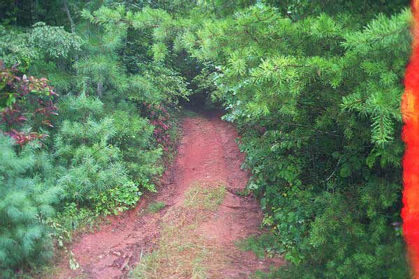

Roadwork and landscaping - FEL, box scraper and a landscape rake.
Snow removal - use the existing back blade. Although where I live I need serios snow removal - rear mounted 78" blower. It's great to go all winter with -0- snow banks, and not have the driveway be reduced to an 8' lane.

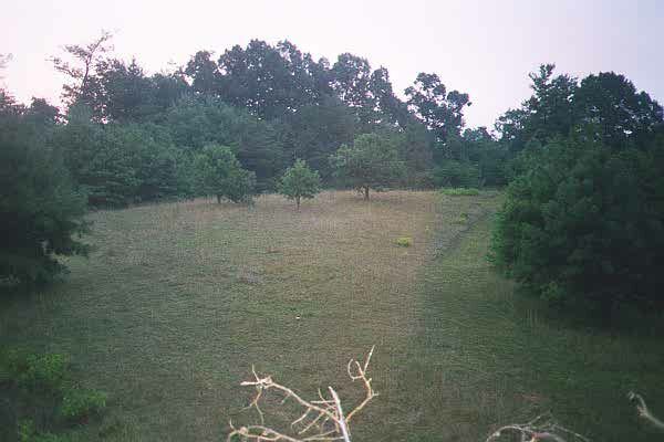

just a couple of pics to show my property here for suggested tractor use.

one more
..road that will need some attention occasionally
